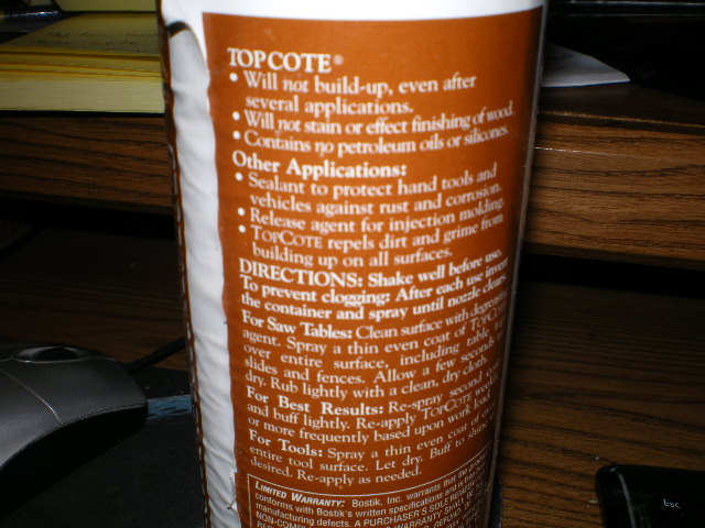

I've always cleaned the holes and legs when I'm cleaning the SS up. That includes waxing them both.
Silicone free????
If using it on saw table surface, will it affect stain/finishing?dusty wrote:I don't know. Is it? Does it need to be? I
I would like to conclude that you have not encountered any finishing problems with projects that were built using top-coted surfaces.
I don't use TopCote on the table tops. I use Johnson Paste Wax there.JPG40504 wrote:If using it on saw table surface, will it affect stain/finishing?
