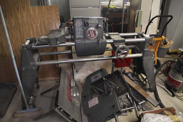

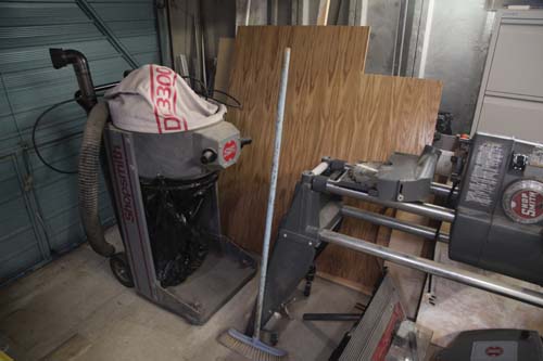

Pix as requested; just after I got the kit into my garage so it's before any cleaning:

It looks like you got a pretty good collection to start with. If you haven't already read some of the "sticky"posts for new owners, and maint. information, please do. There is a wealth of information here. It can sometimes be overwhelming:rolleyes: If you cannot find the information you need, just ask. The folks here have been extremly helpful for me. Good luck with getting the Shopsmith cleaned up and running:)

Yeah, I thought it looked pretty good too - I planned a quick dust down & polish up and then on to making sawdust. Then I turned it on - while I wasn't expecting quiet I wasn't ready for the racket that it made! Hence the strip down.
Or was I just looking for an excuse to get it in pieces?
Anyway, I've replaced the top drive shaft bearings, cleaned everything up & now re-assembling.
