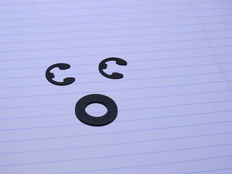

Hi,
These came yesterday from shopsmith.
[ATTACH]16896[/ATTACH]
$.90 ea
Washer $.80
Never heard a 'c clip' described as fragile before!;)

reible wrote:Hi,
$.90 ea
Washer $.80
Thanks for the photos,Ed. So it's an "e" clip, not a "c" clip. Gosh, the semantics involved in parts identification!
Wish I needed something else from SS so I could include these. But it seems like a very small purchase by itself with shipping and all. Guess I'll head to the borg today.
Fred
