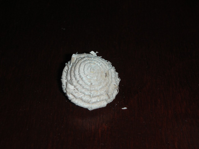

OK, I went down to the shop and tried it with the first piece of wood I came to -- soft maple.
I've included a picture of my first "masterpiece". OK, it was my first attempt. You will see that my petals aren't as long as his. That might be the wood or it might be my technique. I'd bet on poor technique.
Here are some things I learned in my 15 minutes of shop time.
1. You can't tell it very well from the video clip, but for this to work, I had to hold the skew at a very akward angle at least for me. The heel of the skew does the cutting and the long point needs to be almost parrallel with it along the axis of the work. Try it, it's different.
2. In the video, it looks like he is cutting at the very top of the piece -- he is. Again, nothing else in my woodturning experience is done with the tool on top of the work, but it's the only way to cut with the heel and avoid the larger cutting edge (planning edge).
3. In the video, he talks about moving the skew parrallel, but I found it easier to use the tool rest as a fulcrum point and pivot the tool to the left by moving the handle to the right. I was very careful to keep the larger cutting edge of the skew off of the work.
Anyway, I'd be very interested in other's experiences with this.
