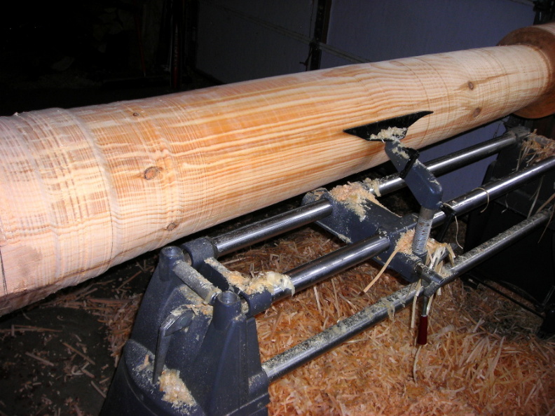

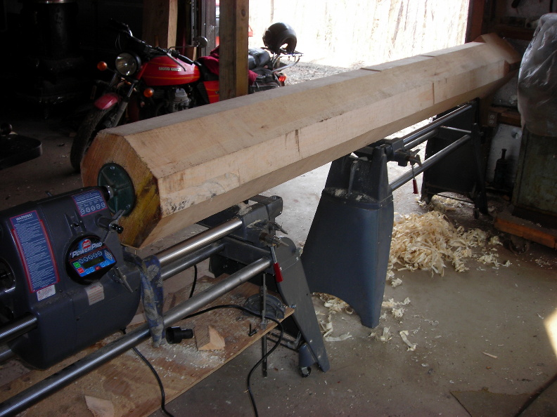

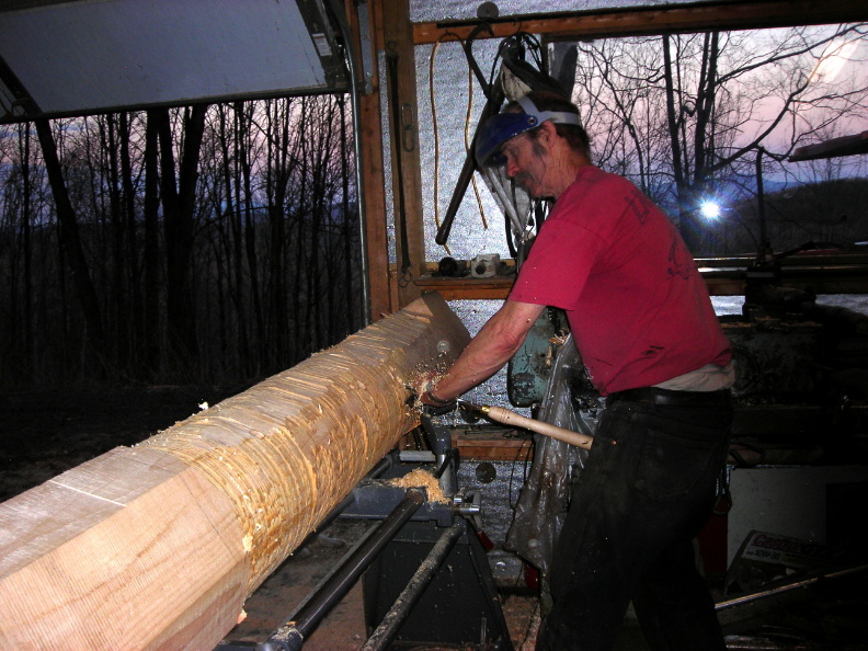

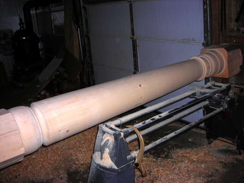

I just finished a project that might interest the wood turners here. Our very old meeting house needed 2 new 11.5 foot columns to hold up the balcony. The pine logs I used are some 350 lbs and over 12" thick. Clips here
http://www.youtube.com/watch?v=rQbzEz0-7X0
This was certainly a challenging project for me and the shopsmith. I run a wood turning workshop here in Vermont so have some familiarity with the tools.
Some inprocess shots follow
Full sequence is here:
http://timetofiddle.yolasite.com/turnin ... olumns.php
I routinely turn work longer than the shopsmith bed. All you do is remove the tail stock, punch a hole in a wall stud at the exact level of you shopsmith spindle and a diameter that is a snug fit for your cup or live center and go to it. Ideal for cant hook handles or chucking up rusty shopsmith tubes for sanding. IF your tool rest doesn't reach, flip the work end for end or as I did- use another shopsmith bed with it's tool rest.
[ATTACH]17084[/ATTACH]
[ATTACH]17085[/ATTACH]
[ATTACH]17086[/ATTACH]
[ATTACH]17087[/ATTACH]
