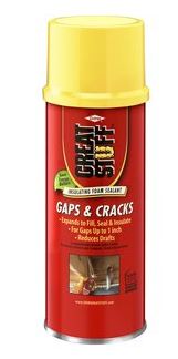

[ATTACH]17215[/ATTACH] $2.94 Walmart

joedw00 wrote:[ATTACH]17215[/ATTACH] $2.94 Walmart
That is the spray-can stuff I was referring to.How much volume per can?
I know from previous use that this stuff is really messy and extremely hard to remove. Any experience with is for packing?
