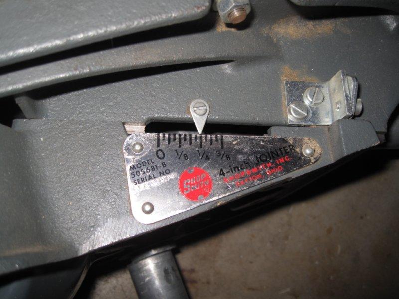

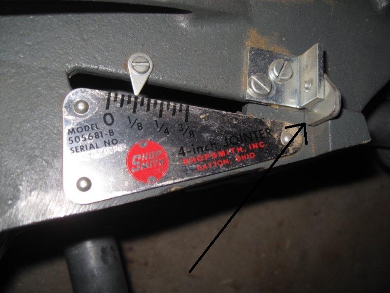

Hello jroberts,
The jointer has an infeed safety stop that prevents it from cutting deeper than 1/8". Just loosen this safety stop and you can move the depth of cut beyond this safety limit. Note this safety limit is there for a good reason.
See pictures attached.
Regards,
Rob
Regards,
Rob
- Safe_stop.jpg (111.48 KiB) Viewed 1398 times
- No_Safe_Stop.jpg (66.41 KiB) Viewed 1398 times
