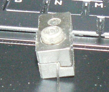

I assume the blade holders are as pictured below.
[ATTACH]17323[/ATTACH]
Not easy to see, but the back of the blade must be positioned against a ridge.

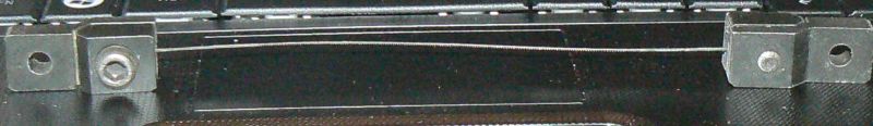

[ATTACH]17324[/ATTACH]
Notice the blade holders are reversed.

Thanks, and yes, those are the blade holders. One of my settings did have the blade against the end, and I tried with the teeth pointed both directions. No difference. I have also been using the alignment slots in the back of the table to hold & align.
I'm begining to think I have a bad batch of blades. The one that came with the machine was dull, but worked fine.
I'll try again as you pictured.

"Stamped" scroll saw blades have a burr (from the manufacturing process)on one side of all teeth, so blade drift on a straight cut is normal. A little practice and you learn to compensate for it.
"Precision ground" blades (for example, Olsen PGT) do not have a burr on the teeth, so they track straighter, but are more expensive.
I recommend the Shopsmith link for general scroll saw instruction, and Sheila Landry's link for more specific info about blade selection.
There's lots of scroll saw videos, forums, and other instructional stuff on the web.
