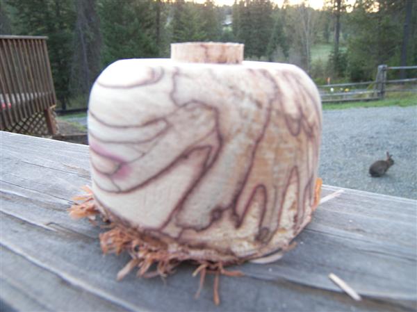

Anybody have any tips on turning spalted birch? I'm a novice turner to begin with and I'm trying to turn some bowls out of some logs that have been sitting for over a year. The blanks are not wet but some of the softer parts I can leave a mark with my fingernail, not too deep. I'm getting a lot of tear out on the end grain sections. How do I tell if it's just too soft for turning?
- Birch bowl 1a.JPG (45.58 KiB) Viewed 2211 times
Paul B
If its that pretty don't be scared of turning it as long as it can be held safely in the lathe. On small items (i.e. pens, bottle stoppers) I use thin CA glue to stablize the punky parts. On bigger items I use Minwax wood hardener or old poly or varnish thinned 1:1 to make it thin enough to penetrate into the wood. I let it dry then stablize it. I don't try to turn punky wood while it is wet. Some also use a salad bowl finish to make it easier to turn.

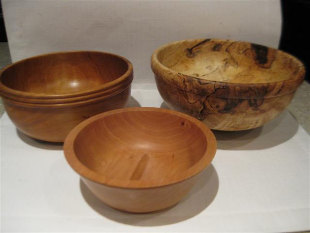

I added a little temptation to my post. The bowls are clockwise: bradford pear, cherry and spalted maple.
