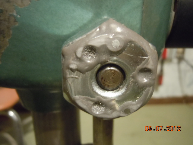

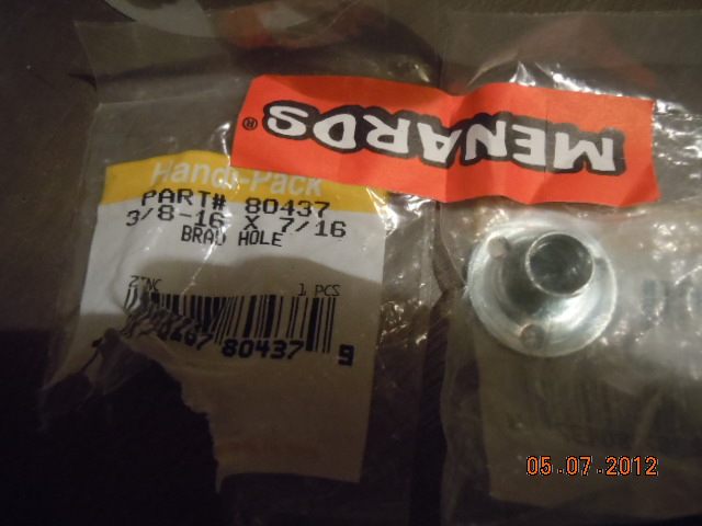

I fixed it. I used a 3/4in nut and drilled it out alittle to 13/16 about a 1/4 down on one side. I then used a Brad Hole 3/8-16x7/16 from menards (part #80437). This I held in position with a small c clamp and drilled some small holes about 1/4 in deep that I could stick a small nail into. I glued it on with some proffesional grade JD weld and stuck the nails in. The next day I sniped off the nails and filed them down. It is working great so far.
