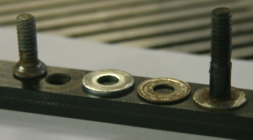

Well, it looks like I'm at the same point as Sam in MN in getting a SS back into action. I'm having "fun" with the Miter Gauge too
so it seems appropriate to add my questions here.
I stripped & cleaned it & now that its back together my big problem is with the Nylok screw attaching the bar to the protractor at the pivot point. Prior to cleaning, I'm sure I checked it and was able to change the angle without the Nylok screw moving with the bar & coming undone. Post re-assembly it just won't stay tight. Have I "cleaned" off some special coating - I recollect brushing off a powdery material that I thought was oxidised aluminium. I'd appreciate suggestions for solving this issue.
I also have doubts about the washers so confirmation that they are the original parts would help. The sizes I have are:
OD: both 5/8"
Thickness: 277 Special Washer: 1/32"; 269 Washer: 1/16"
[ATTACH]17379[/ATTACH]
This pic shows (L to R) the Nylok screw, 269 washer, 277 washer from the pivot point & the 277 stuck at the base of the lock knob stud. I have only that one 269 washer under the lock knob, the exploded view in the manual shows 2. Is there a particular reason for 2 as this doesn't seem to affect the function?
The special washer at the base of the Miter Stud (278) is firmly stuck to the Bar, so much so that I initially thought it was machined as part of the Bar. It's also showing signs of wear from the protractor travelling over it. It's either completely rusted on or the Miter Stud is locking it on. Is there a way to remove the Miter Stud from the Miter Bar to release that washer? ( in a non-destructive way! I'll have to put it all back again).
On top of all that, with the Nylok screw tight the Protractor hits the edge of the table when sliding it in; when the screw has slackened off after setting an angle it glides smoothly over the edge. Marks on the table edge suggest the PO suffered this for some time. I'm hopeful that the solution to this lies in solving one or more of the questions above. Either that or I may have to use a thicker washer between the protractor & bar at the Nylok screw. Note that my bar is perfectly flat.
