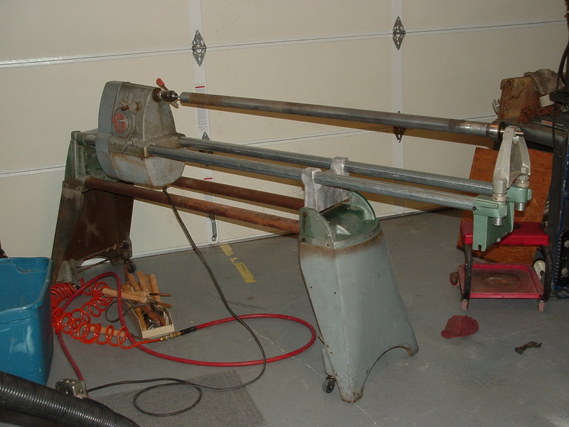

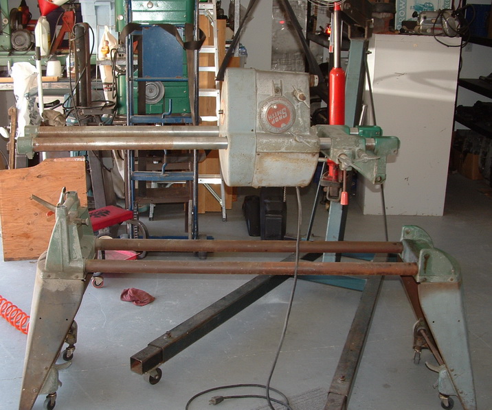

I've been planning this for awhile now, finally had enough downtime and a very sad neglected 56 Greenie to base it on. The end cap is from a Mark 2 which is a total P.O.S. and not worth resurrecting. The intermediate piece is cut down from a Goldie that was wasted and only good for parts.
I have a large pile of way and bench tubes to clean and polish (16 or more) and cannot put it off any longer. Thank Dog for 1.75 EMT.
The funny thing is, as horrible as it looks, this Greenie is one of the smoothest running Mark 5s I have ever had the pleasure to operate!

The first part is really just de-rusting, with sand paper while spinning.
Finer and finer paper until you end up with super fine wet n dry paper. That's my take anyway.

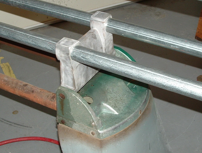

I like yer setup. a leg under the end would minimize effect of EMT flexing(sagging).
Longer ala 1 1/2" EMT(electrical conduit) with a 1 3/4" od(very close)They come in 10' lengths.dforeman wrote:Are those extra long way tubes on top or are the lower tubes just shorter?
these way tubes are about 7 feet long.

Red, no flexing or sagging....yet.
Once this big batch of tubes is done it'll be reassembled as a proper Mark 5, and become the shop beater.
