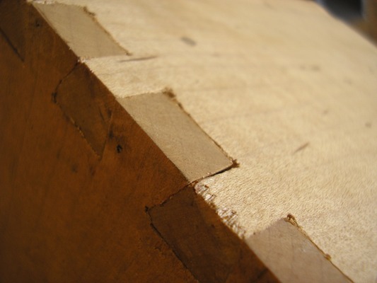

Here is the desired look. The piece on top would be the drawer front. Be sure to orient to get this configuration.
[ATTACH]17480[/ATTACH]

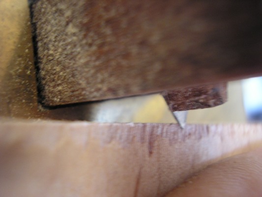

First, use a marking guage to set the width of the board on the guage.
[ATTACH]17481[/ATTACH]

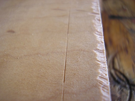

Mark the board face with this setting.
[ATTACH]17482[/ATTACH]

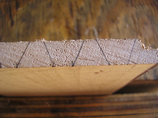

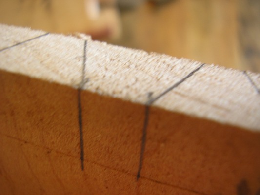

Use a pencil and mark the edge of the board. Space the pins to that the narrowest part still has room to pass your smallest chisel through.
[ATTACH]17485[/ATTACH]
Bring the lines down the face of the board to mate the lines from the marking guage
[ATTACH]17486[/ATTACH]

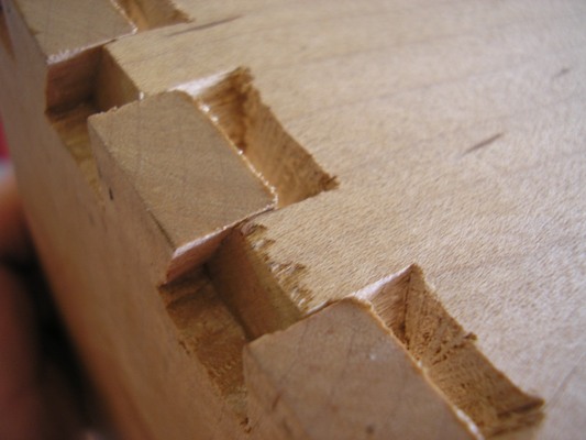

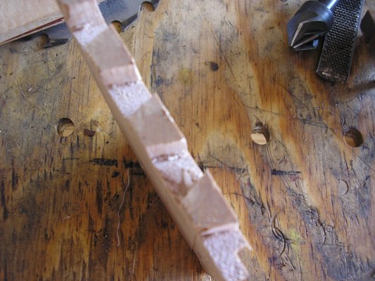

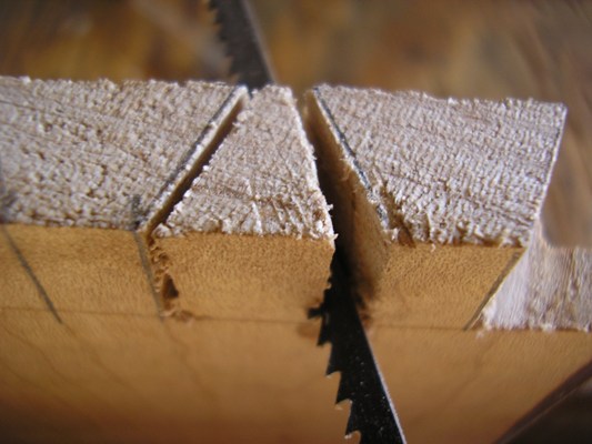

Use the coping saw to cut the material away. LEAVE THE LINE. Cut a small wedge out of the waste material so you can rotate the coping saw and cut perpendicular to the first cuts.
[ATTACH]17487[/ATTACH]

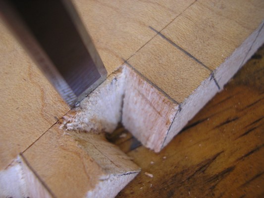

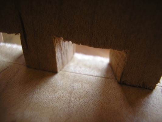

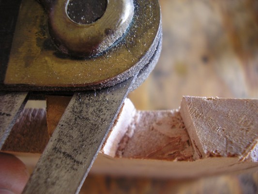

Use a chisel to clean up. Plunge straight down. Clean up ever so slightly. You can trim to fit during fit up.
[ATTACH]17488[/ATTACH]

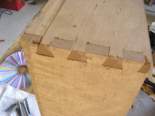

Use the pins to mark the tails. Fat side of pin in, contrary to the pic and marks.
[ATTACH]17489[/ATTACH]
A long view. Reference the first pic if needed. Fat side of pins in. I seem to have marked the opposite in a rush but show it in this pic.
[ATTACH]17492[/ATTACH]

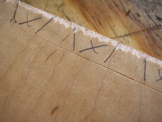

The fat side should be in instead of out. Oh well. Use a pencil and mark between the pins on the face of the board. X where the material should be removed.
[ATTACH]17491[/ATTACH]

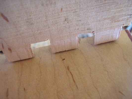

Test fit. Notice the Fat side of the pins is on the inside of the corner. My pic shows otherwise but I was really rushing.
[ATTACH]17493[/ATTACH]
Tight.
[ATTACH]17494[/ATTACH]

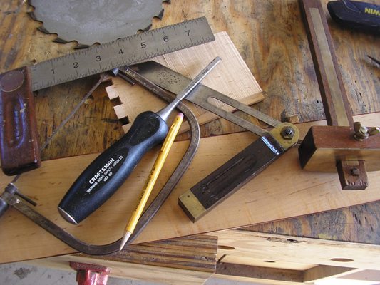

All the tools you need. I made the marking guage out of walnut and some brass I get from the local trophy shop. You really need one to do a number of techniques.
[ATTACH]17495[/ATTACH]
