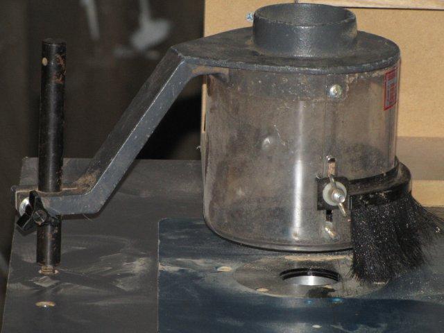

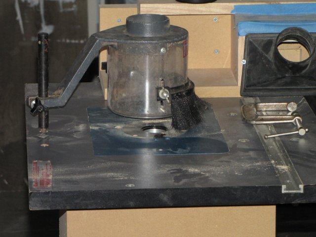

In one of my less than brilliant moments, I purchased on e-bay ss pn 515704 which is a "Full Length Dust Shield for the Speed Increaser and Guard and Support Assembly for the Free Standing Router Table"(pant pant).
It was intended to be an improvement over the standard shield included with the speed increaser.
IIUC the free standing router table has a threaded hole that the post screws into.
515704 includes the modified shield, brush etc. and a post(with a studded end only - no t-nut).
The shield does not have the cutout area that the standard shield has.
I assume the clamp and threaded bar is included with the speed increaser 'kit'.
The single page instructions refer to the manual of the SI or SART for detailed mounting instructions.
JPG40504 wrote:In one of my less than brilliant moments, I purchased on e-bay ss pn 515704 which is a "Full Length Dust Shield for the Speed Increaser and Guard and Support Assembly for the Free Standing Router Table"(pant pant).
I think this is the dust shield and mount you are referring to.....on my modified SS router table.
[ATTACH]17520[/ATTACH]
[ATTACH]17521[/ATTACH]
- IMG_8063.jpg (44.48 KiB) Viewed 2424 times
- IMG_8064.jpg (42.19 KiB) Viewed 2422 times
Bud F.
- Posts: 35598
bffulgham wrote:I think this is the dust shield and mount you are referring to.....on my modified SS router table.
Yep!!!!!!!
