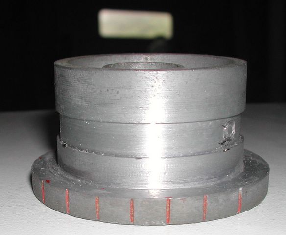

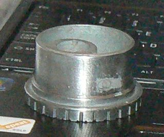

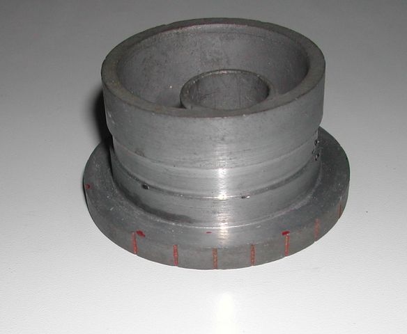

I would like to see a pix of this 'grooved' eccentric. This has me baffled.
getnby41
Posts: 34
Joined: Sat Nov 19, 2011 10:01 pm
Pictures
Post by getnby41 »
Here are the pictures of the eccentric. It looks like someone put it in a metal lathe and turned it down.
[ATTACH]17526[/ATTACH]
[ATTACH]17527[/ATTACH]
[ATTACH]17528[/ATTACH]
James Phillips
Mark V 510 / Bandsaw
getnby41 wrote:Here are the pictures of the eccentric. It looks like someone put it in a metal lathe and turned it down.

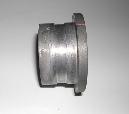

Interesting! It appears that the centering lip was also removed.
[ATTACH]17529[/ATTACH]
Also shown is a less drastic 'repair'(jb weld).
This 'feature' is not one of ss's best.;)

I wonder if this is from a clone. It does not look like an OEM Mark V/5 eccentric.
