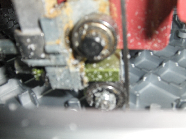

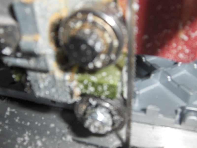

[ATTACH]675[/ATTACH]
[ATTACH]677[/ATTACH]
[ATTACH]676[/ATTACH]
I noticed that the bottom roller was much too far forward such that the top roller never touched. I adjusted them so now both rollers move. I have not tried it yet but I don't think it will matter. I did not know carter offered another choice for the Shopsmith bandsaw.

Looking at your photos, I would have said you have a Carter guide.
Yours looks to be the single bearing type that ed commented on.
http://carterproducts.com/
The Carter site does not list Shopsmith; however, they state that your bandsaw can be converted - just contact them.
