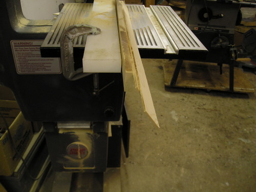

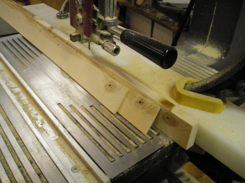

Bandsaw tracking
Post by dougrl »
Here are some pictures for you to see. I am not trying to start a Fight or anything, as this is for your info only, It took me 4 mins. to set up my home made fence, 3 7/8" at each end, no allowance for drift. I was not worried about the thickness of the cut. it turns out that it is just under 1/8". I just want you to see what "this bandsaw will do". It is one of the best little BS I have used. I, also used the WRONG BLADE, 72" 3/8 x 10 TPI. I should have used a blade, 3/8 x with 3 TPI, as it would have cleared the sawdust faster and made life easier for the BS. I will tell you, that I could resaw 6" oak with it. I did this free hand no guides just shoved the wood through, [as picture #1 shows where I stopped and changed hands] I only measured two of the pieces were out about 4thou. from one end to the other. Gentlemen, I truly believe
BS drift went out a long time ago. Set your machine up and, Buy a good blade that has ground teeth, not stamped, and use it for resawing only, Nothing Else. buy another blade for every thing else. A Very Merry Christmas To You and Your's. Cheers Doug & Marilyn in cold Canada.
[ATTACH]682[/ATTACH]
[ATTACH]683[/ATTACH]
[ATTACH]684[/ATTACH]
[ATTACH]685[/ATTACH]
Way to go Doug! I like your use of the UHMW plastic. I've used similar fences for routing. Also I agree the Shopsmith bandsaw is a great tool!
For me drift all depends on the blade I'm using at the time. I have one 5/8" blade ,4TPI, I use for resawing. It cut perfectly straight for a while then started to drift right. Remembering my days with two man cross-cut saws, I grabbed a punch and a hammer and re-set some of the tooth set. Miraculously - it cut straight again.
It is really easier to adjust the fence for the current drift - like recommended by professional woodworkers, but just wanted to say this other method will also work for those so inclined to fix the cause. Since the set of the teeth will continue to vary a bit depending on the way a particular blade (the teeth) have been stressed (and dulled) while cutting - re-setting is kind of fruitless. It was just interesting to me that it could be done.
