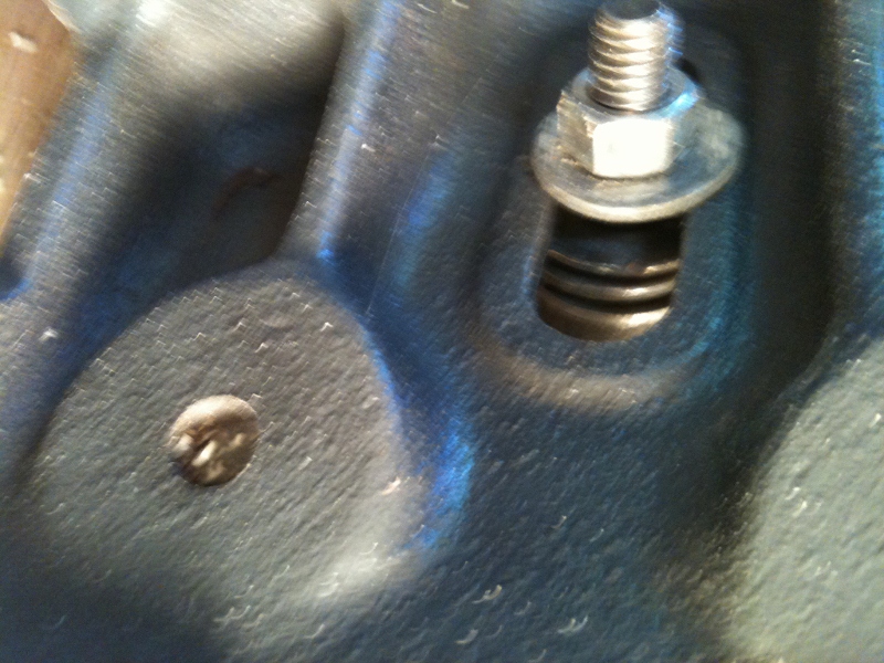

Post by bpress54 »
Here's the setup, from what you said it looks to be correct

Post by SDSSmith »
bpress54 wrote:Here's the setup, from what you said it looks to be correct
No, the entire washer stack sandwich goes between the nut and the slot. It appears as though you only have one washer where there should be 5.
Rob in San Diego
SDSSmith
Posts: 1940
Location: San Diego, CA
Post by SDSSmith »
[quote="bpress54"]OK, that's how I have it, but I also put a flat washer between the nut and the base because it seems the nut wanted to slip into the groove without it. It just won't cut properly]As I noted in this post, put the five washer sandwich stack where you have placed the one washer. That is between the groove (as you describe it) and the nut.
