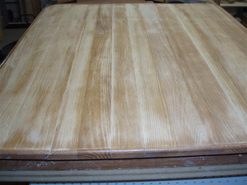

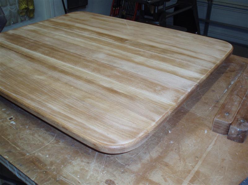

I have been given the task of refinished a drop leaf table that came from our fifth wheel trailer. Had it been stored properly there would be no need to refinish it; but there is.
I thought - "no problem". Hit it with a light sanding, follow with some fine steel wool and your ready to go. Well it is not happening that way.

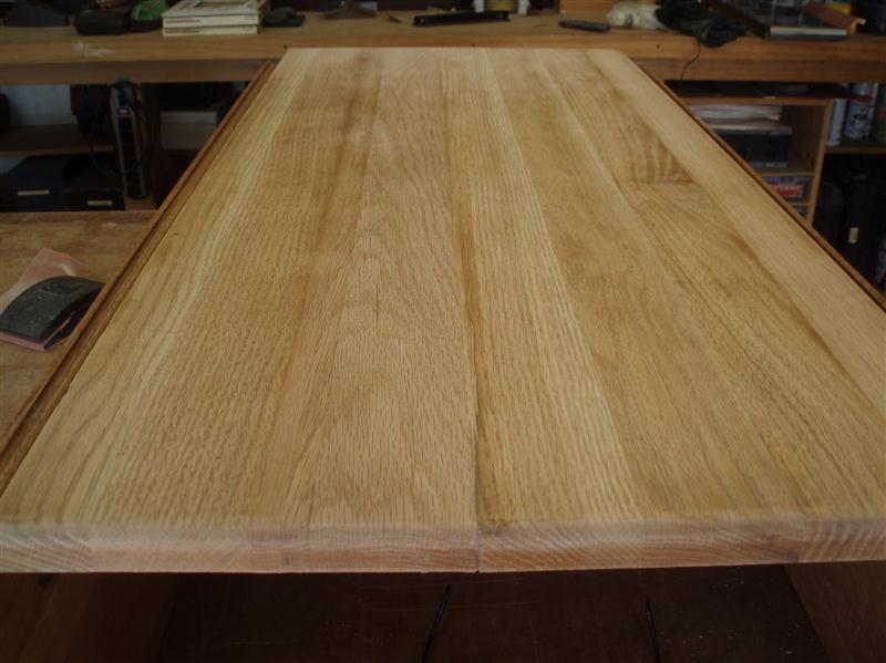

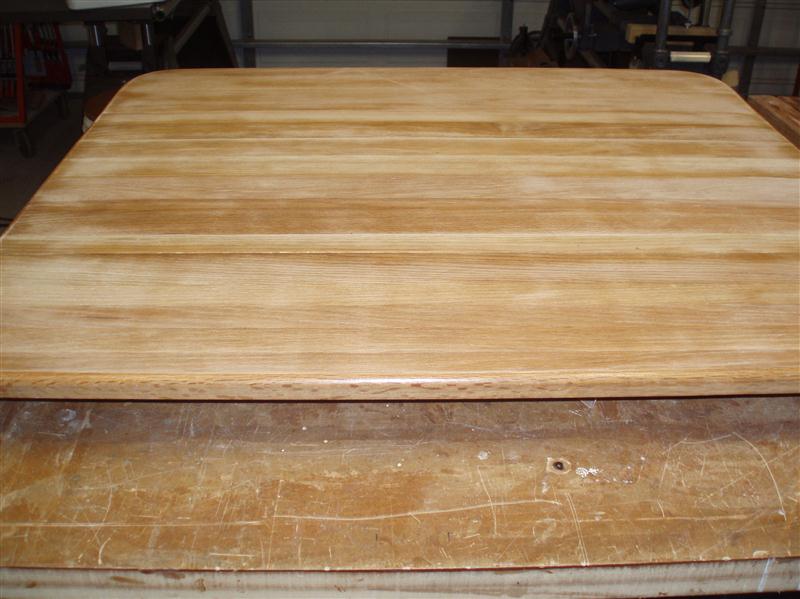

I have sanded the surface (not the edges yet) and what I now have is a field of blotches that I know will draw negative comment from "Quality Control".
If anyone can tell me what I have done wrong and what I need to do to recover, it will be greatly appreciated.
The table top is as smooth as silk (except where the drop leaves meet the main table). I'm going to live with those two joints.
[ATTACH]17697[/ATTACH]
[ATTACH]17698[/ATTACH]
[ATTACH]17699[/ATTACH]
[ATTACH]17700[/ATTACH]

Try wiping it down with a damp rag and see how it looks. But it looks to me it just needs more sanding to remove the old finish.

Do you have a scraper? If not an old Stanley then how about a scraper from lowes or HD? They have replaceable blades. Use it on the pull stroke. Youll suddenly notice the blotches fade and there should be no tear out. You'll get an incredibly smooth finish. I use scrapers after hand planing to even up any groves etc.

Beeg sent me back out to do more sanding. I think it might have worked.
[ATTACH]17701[/ATTACH]
Just sanded.

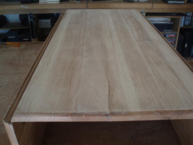

[ATTACH]17702[/ATTACH]
Wiped with mineral spirits.

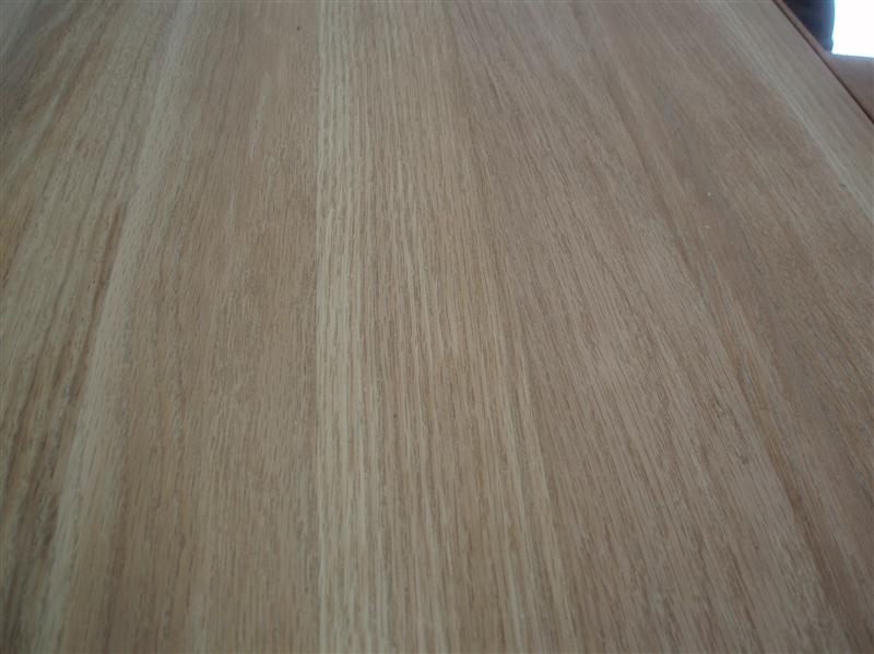

[ATTACH]17703[/ATTACH]
Closeup of some of the problem grain.
It is smooth but because of the wide variety of grain patterns I don't believe it is ever going to look really good. This table top is from a piece of furniture built by a company that specialized in RV furniture (Hi-Lo Furniture, I think). It is either a dining table or a coffee table thus the name Hi-Lo I guess. You can see that it was made by laminating narrow pieces to create the table top. This accounts for the convoluted assortment of grain patterns.
The important part is getting Quality Control approval and 'so far' that is happening.

Look good now. So what was the final grit sandpaper did ya use? I don't think I'd go much over 150 myself. So whats next for this project?

In finishing the table, one possibility is to use gel-stain, which really is a gelled varnish with stain/dye in it. It likely would even out the color. You can simply apply a bit more of the gel-stain in the lighter areas (or less in the darker areas). After evening out the color, you can top it off with a couple of coats of gel-varnish.
Art in Western Pennsylvania
beeg wrote:Look good now. So what was the final grit sandpaper did ya use? I don't think I'd go much over 150 myself. So whats next for this project?

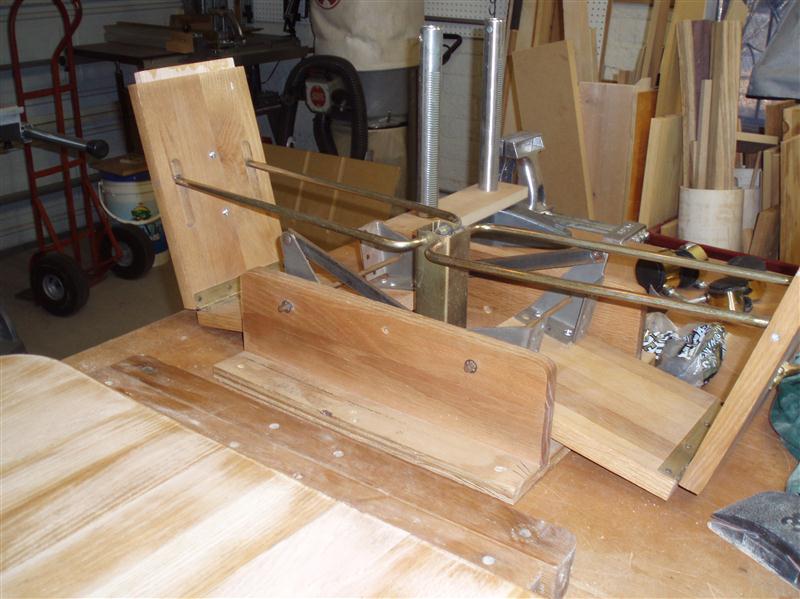

This sanding was done with 150 grit and all that is done is the center of the table. The drop leaves and all the vertical support mechanism is yet to be done. The base of the table can be seen in one of the first four pictures.
