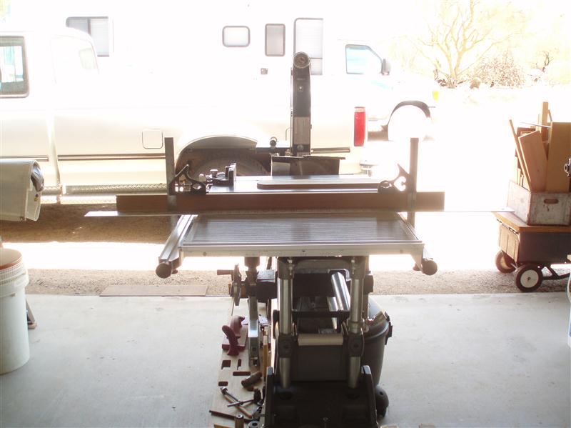

It is not really all that large but is quite adequate for my use. The table itself measures 22"x17" but what I really am trying to confirm is the span of the table (infeed to outfeed) including the front and rear rails.
Mine measures 26 3/32" measures like this:
[ATTACH]17853[/ATTACH]
I would certainly appreciate verification of this dimension from at least two or three of you.
PS: I checked a second table and the rails measure an exact 26".

dusty wrote:It is not really all that large but is quite adequate for my use. The table itself measures 22"x17" but what I really am trying to confirm is the span of the table (infeed to outfeed) including the front and rear rails.
If'n I had 520 'stuff' I would be glad to oblige, but that is not the case.
I have a ? regarding the 'elevation' of the tubes in the rails. Are the front and rear the same(actually distance below the table top). i.e. If the floating tables were assembled to the tubes backwards, would the table tops still be co-planer albiet off set f-r?

I am not certain that I understand your question. If one uses the gauges that are sent with the 520 upgrade kit, the top edges of the front and rear rails set in the same plane (the same distance below the main table plane).JPG40504 wrote:If'n I had 520 'stuff' I would be glad to oblige, but that is not the case.
Extension tubes, properly secured in both the front and rear rails, will be parallel to one another and in the same plane.
If this does not answer your question, please give me another chance.
How far in the vertical direction are each of the front and rear extension tubes from the top of the table. Easiest way to measure is to set a floating table top side down on a flat surface and determine the distance from the flat surface to an extension tube(top or bottom).dusty wrote:I am not certain that I understand your question. If one uses the gauges that are sent with the 520 upgrade kit, the top edges of the front and rear rails set in the same plane (the same distance below the main table plane).
I merely want to know if the front and rear 520 rails locate the tubes vertically the same.
If so, connecting a floating table reversed front to rear will still be flush with the main table top. That is true for a 510 since the rails are identical.

If I had 520 tables/rails, yes. I ask the question for future reference when I will have 520 stuff!mikelst wrote:couldn't you take two extension tables and reverse one. Then run the tubes into them and see if the tables are level?
JPG40504 wrote:How far in the vertical direction are each of the front and rear extension tubes from the top of the table. Easiest way to measure is to set a floating table top side down on a flat surface and determine the distance from the flat surface to an extension tube(top or bottom).
TIA
Yes, that is true. I thought I had said that in the previous post but I guess that plane needs to be horizontal. It is horizontal.
Photographic confirmation to follow.
dusty wrote:Yes, that is true. I thought I had said that in the previous post but I guess that plane needs to be horizontal. It is horizontal.
