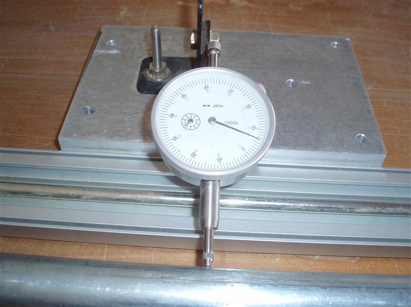

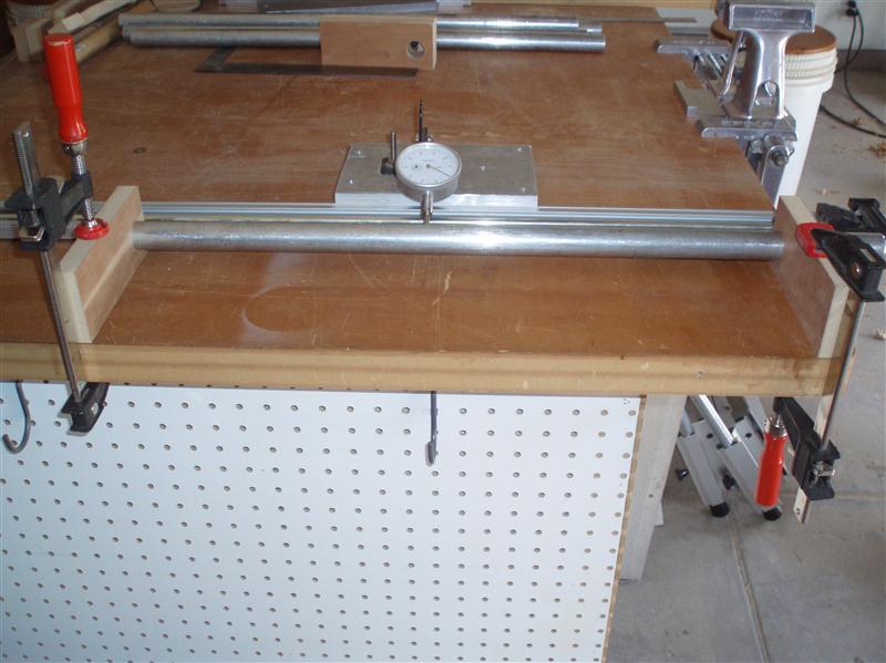

Now I am attempting to confirm whether or not an assortment of bent extension tubes that I have are contributing to this alignment issue.
By using the method shown in the following five images, I have concluded that I have NO STRAIGHT TUBES.
[ATTACH]17868[/ATTACH]
Overview of Test Method Using My Best Tube
[ATTACH]17869[/ATTACH]

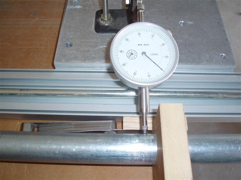

Zero Left Side
[ATTACH]17870[/ATTACH]
Zero Right Side (notice the feeler gauge)
[ATTACH]17871[/ATTACH]

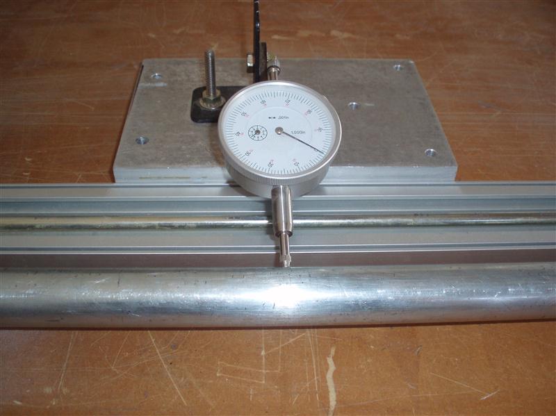

Rotae and Test
[ATTACH]17872[/ATTACH]

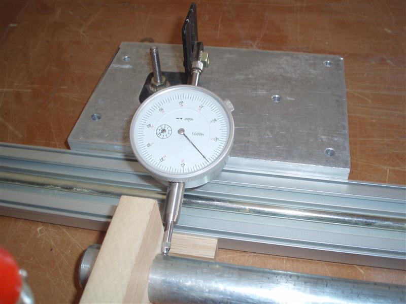

Rotate Some More and Test
However, when I have an alignment problem that I cannot correct, I have to investigate all possible causes. While doing just that, I discovered that I do have an alignment problem that apparently had been covered up by some past corrective action that I took.
Zero Left Side
Rotae and Test
- Overview of Test Method (Custom).JPG (67.62 KiB) Viewed 1842 times
- Zero Left Side (Custom).JPG (64.59 KiB) Viewed 1854 times
- Zero Right Side (Custom).JPG (67.99 KiB) Viewed 1863 times
- Rotate 1 (Custom).JPG (61.39 KiB) Viewed 1861 times
- Rotate 2 (Custom).JPG (66.38 KiB) Viewed 1864 times
