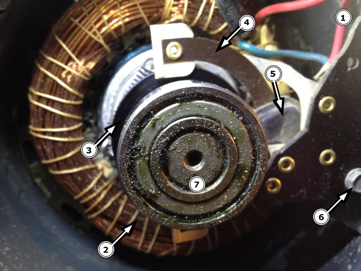

JPG40504 wrote:Check the operation of the switch by connecting the multitester(ohms) across the switch while moving the actuator.
Item 1 in the attached photo is the red wire that goes to the capacitor.
Item 2 points to the switch terminal for the blue wire that goes to the electric motor's windings.
When I first tested for continuity across the switch (from the red wire's terminal to the blue wire's terminal), nothing happened.
Item 3 points to what I believe is the switch actuator. When I touched the switch actuator, I got continuity across the switch... until I rotated the electric motor shaft by hand. As I rotated the electric motor shaft by hand I found two or three places in the rotation where I would momentarily get continuity as the shaft turned, but there was no continuity for the vast majority of the rotation.
If I pull the actuator towards the back of the electric motor, I can get continuity across the switch.
If I push the actuator towards the electric motor's shaft end, continuity comes and goes as I'm moving the actuator, but I when the actuator reaches the end of its travel I cannot get continuity.
Item 4 is the right leg of a "Y" shaped yoke.
Item 5 is a rubber boot that covers the area where the two legs of the "Y" meet.
If I press on just about any part of the "yoke" or on the rubber boot, I get continuity across the switch. The continuity gets broken as soon as I start to turn the electric motor's shaft.
Item 6 is one of two bolts that appear to hold the entire switch assembly in place.
While moving the actuator towards the electric motor's shaft, I discovered more sawdust. I blew out the area with compressed air as I moved the actuator in and out. It didn't have any affect on the switch's continuity, but as you can see at item 7, the back end of the bearing attracted a fair amount of sawdust.
