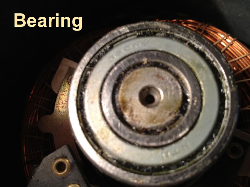

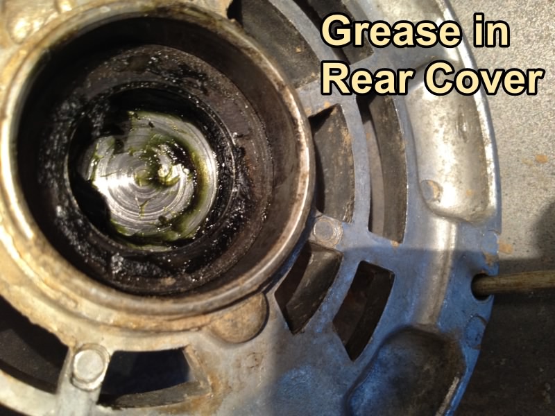

There was definitely grease on the back end of the bearing, and enough grease accumulated in the back cover of the electric motor that I have a hard time seeing how it could have leaked out of the bearings.
There are two metal "rings" sitting in the grease in back cover of the electric motor. The first time I took the electric motor apart, one of those "rings" stuck to the bearing. Since then, the "rings" have been staying in the back cover when I've taken the cover off.
I've attached photos of the bearing and the back cover. The side of the bearing shown was pretty much coated with grease when I first opened the motor. I wiped the grease off before testing the motor so I wouldn't have a ton of sawdust running through the bearings.
- ShopsmithMotorBearing.jpg (78.45 KiB) Viewed 3650 times
- ShopsmithMotorGrease.jpg (122.39 KiB) Viewed 3627 times
That does not look right. It does not even look like what I would expect motor bearing grease to look like. I know that I would change bearings after seeing that.robfish wrote:There was definitely grease on the back end of the bearing, and enough grease accumulated in the back cover of the electric motor that I have a hard time seeing how it could have leaked out of the bearings.
