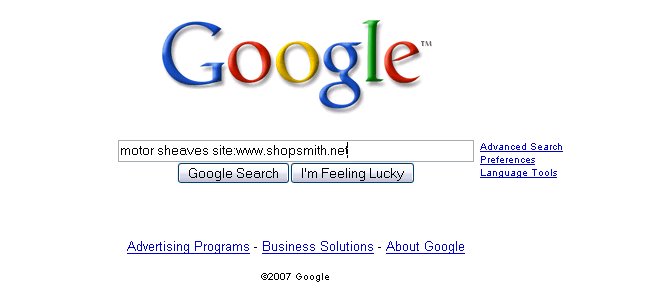

Mmmmm see pictures below, 1 and 2
Can you do any searches on Google?

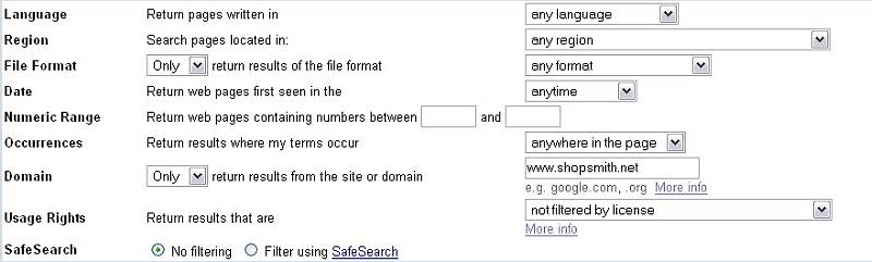

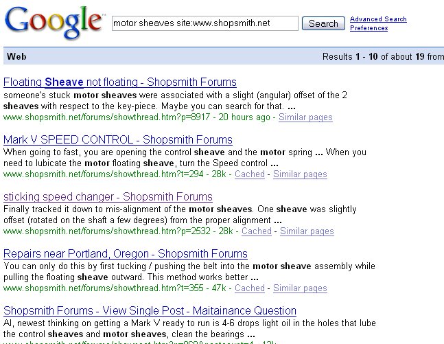

If you can use google then you can also go to advanced and then put the site in as shown in picture 3.
I've used this for years and I know it works.... not sure why it is not working for you or are you pulling my chain???
