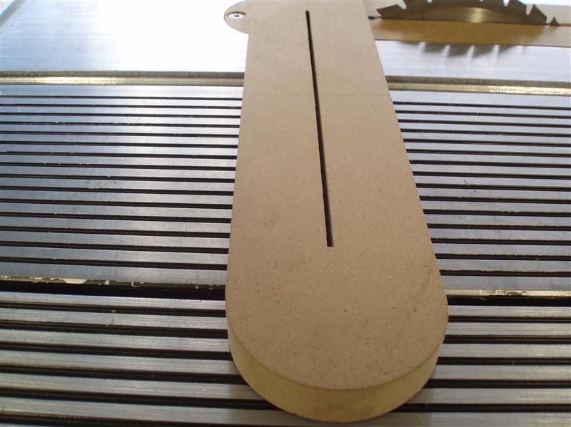

[ATTACH]18006[/ATTACH]
Just a thick ZCI made right after that table was carefully aligned. I do not power the Mark V with this installed to preserve tight fit.

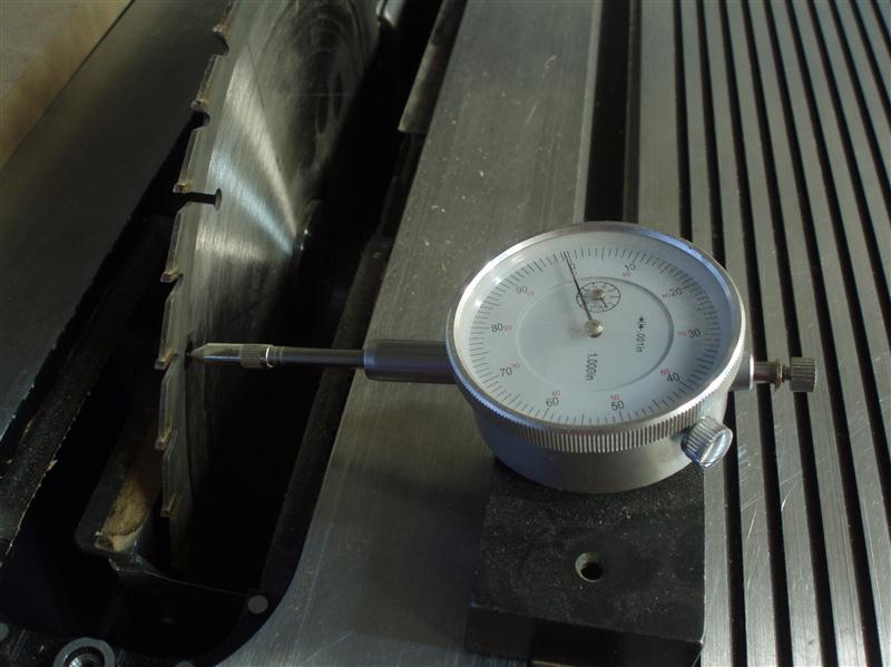

[ATTACH]18007[/ATTACH]
Mark on the blade should be vertical and should align with mark on ZCI.

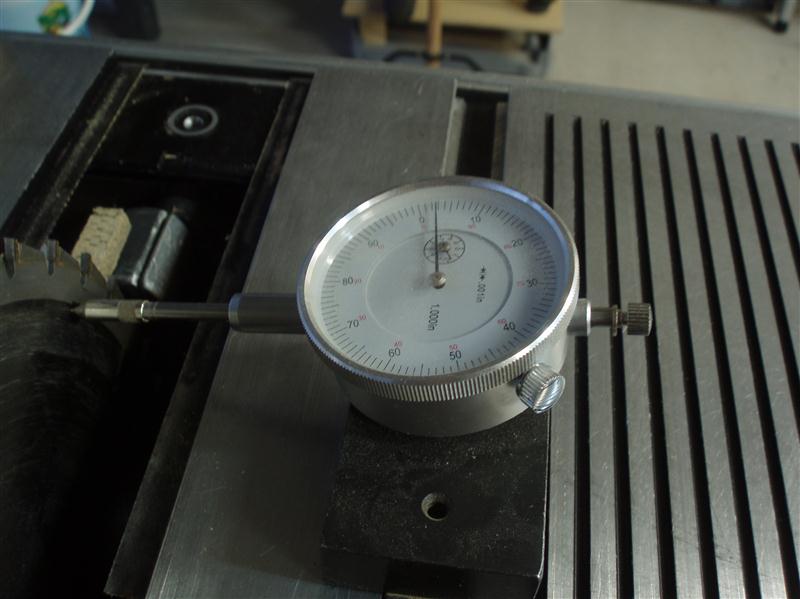

[ATTACH]18008[/ATTACH]
Close enough for all of us.

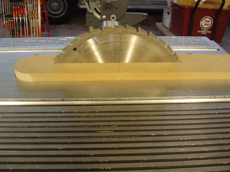

[ATTACH]18009[/ATTACH]
Equally close.
Equally close.

I thought the whole idea of table alignment was to kill a couple of hours in the morning so the day won't be so long:D I do have a question. Do you use a specific saw blade to make the jig and when doing the alignment? Are all saw blades the same width? Thanks in advance for your answers. I just ordered the SS dial indicator so I can perform this task. How did you make the jig. Cut the slot first, then trace the shape from the removed insert and cut on the band saw?
Fred Sheldon
The Woodlands, Tx
The Woodlands, Tx
fredsheldon wrote:I thought the whole idea of table alignment was to kill a couple of hours in the morning so the day won't be so long:D I do have a question. Do you use a specific saw blade to make the jig and when doing the alignment? Are all saw blades the same width? Thanks in advance for your answers. I just ordered the SS dial indicator so I can perform this task. How did you make the jig. Cut the slot first, then trace the shape from the removed insert and cut on the band saw?
I use a thin kerf. All of my thin kerf are the same thickness.
I made the insert first. Then on a table that I knew to be properly aligned, I cut the kerf.
The insert, to be used for alignment, must fit tightly in the table cutout. I cut it to width and then rounded the end using the bandsaw and belt sander. This is a cut to fit project.

I would hope that a vast majority of the forum members would make this for themselves before they would buy it. Getting accurate measurements and fitting the insert with precision is the time consuming part - 10 minutes maybe.
Getting the table aligned before making the kerf cut is the really important part. However, remember that 'perfect' is in the eyes of the user. The purpose of this jig is to allow you to return your table to 'what you consider perfectly aligned' in a minimum amount of time and with no fussing around with dial gauges and the like.
I am satisfied with my table as long as the measurements are within +- .005". When they come out per the images in this thread, I am delighted. The next guy might not be.
