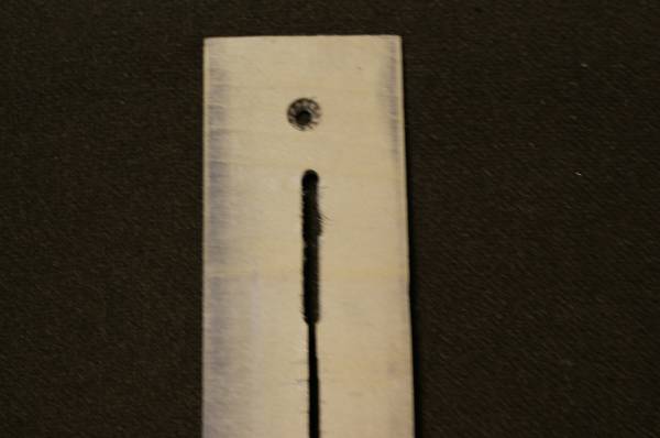

I make my own ZCI's using 1/4" plywood and the slot is cut by raising the blade through the insert. The slot is extended using the router table and a
1/4" bit as seen in the photo. This permits the use of the riving knife and upper saw guide.

OK photo did not load the first time sp here I go again.
[ATTACH]18035[/ATTACH]

wa2crk wrote:OK photo did not load the first time sp here I go again.
Here is a discussion on ZCI construction. I made a sled to cut the kerf including that needed for the riving knife.
I use the same sled, in the drill press mode to drill the holes for the mounting screws. After doing one, the rest are identical.
