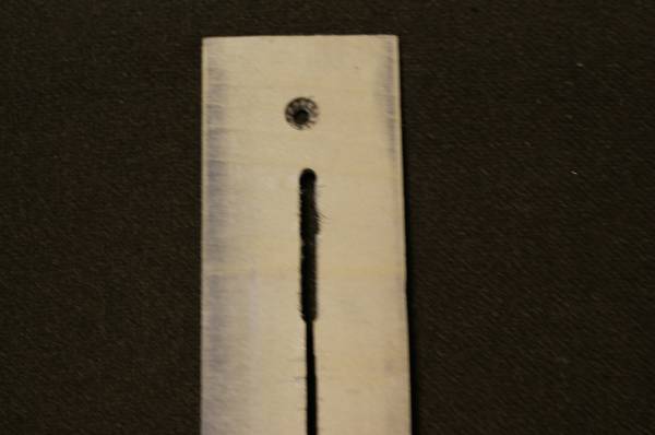

Nice job on the ZCI. I didn't think to use left over flooring pieces. We just had the house done in Brazilizn Rosewood and I have a bunch of pieces left over. You may want to think about making a wider slot behind the saw blade opening by using a 1/4 " router bit in a table to clear the riving knife and the upper blade guard. I had a piece of wood thrown back at me last year by not having the guard in place and it still hurts when I think about it.

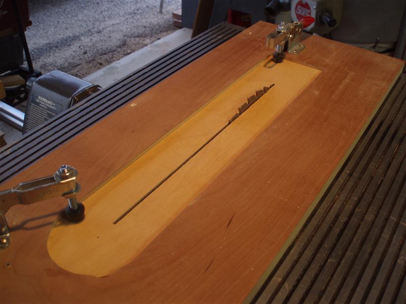

The Upper Saw Guard mounts through this same kerf and I like to keep the kerf tight. For that reason, I extend the kerf using the saw blade. To do it quickly and easily, I build a sled. It is just a piece of wood with a runner and a cutout for the ZCI to set in.

Thanks bill V, I've got that on my "finish up" list as I ran out of time yesterday before we had to claen up for din-din.......
Hey dusty, great idea! I will probably try the router grove first as My riving knife/blade guard clamp seems to be right in line so the blade has to hug the lower guard......but I haven't finished looking at things just yet. just wanted to get the first one done and see what problems I ran into.......
