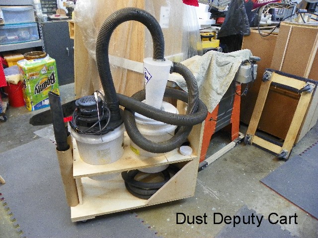

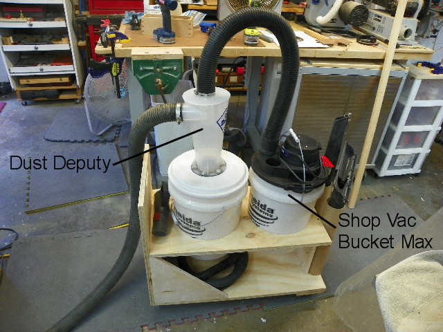

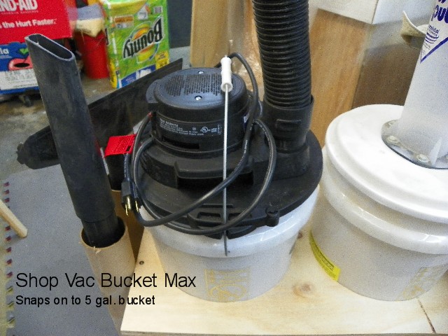

I have had my Dust Deputy for a couple of years now and finally got around to building a cart for it. I was in Lowe's the other day and noticed that Shop Vac has a unit called Bucket Max (about $30) that snaps on a 5 gal. bucket. It hit me that this would work perfectly with with my Dust Deputy. The cart is made entirely of left over 3/4" ply from a previous project. The combination works perfectly so I guess it was worth the wait for the cart.
- Cart Left Side.jpg (109.86 KiB) Viewed 6908 times
- Cart Right Side.jpg (127.85 KiB) Viewed 6771 times
- Bucket Max.jpg (94.5 KiB) Viewed 6778 times
- Accessory Caddy.jpg (121.92 KiB) Viewed 6763 times

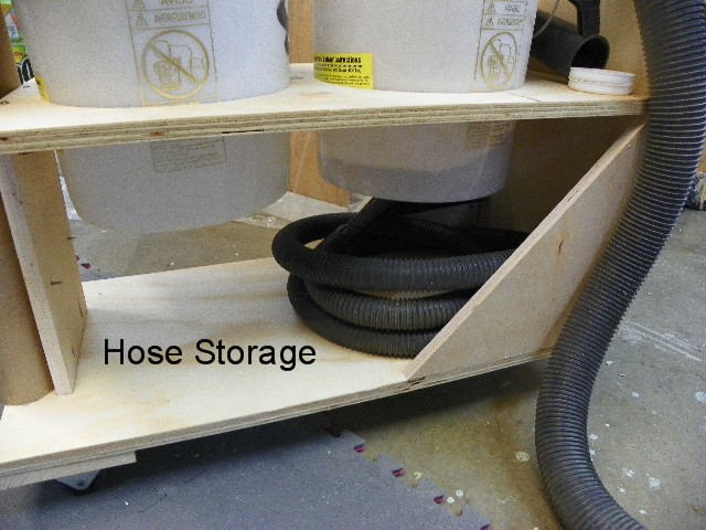

- Hose Storage.jpg (100.47 KiB) Viewed 6753 times

I noticed in the hose storage picture what appears to be two screws protruding inside the storage area from the accessory storage side. Looks like they could easily give you a nasty cut if you aren't careful. I suggest you cut off the protruding pointed ends of the screws and then file them level with the plywood.
Please take this as a helpful suggestion rather than a criticism which it is NOT! I make many dumb decisions I have to fix in my projects so I'm not one to criticize others.

Screw a couple of scrap/cutoff pieces onto them pointy things!;)

Have we seen pictures and info on the storage shelves that look to have sliding trays/drawers that is sitting in the back left corner of the first picture?

Farmer, that is a my grinding wheel/lathe tool sharpening station. I found it at a "Big Lots" store on sale for about $15 bucks. I liked the sliding trays better than the drawers. It's a cheapie but it works great.robinson46176 wrote:Have we seen pictures and info on the storage shelves that look to have sliding trays/drawers that is sitting in the back left corner of the first picture?![]()

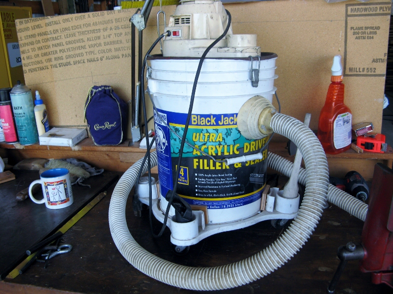

Thanks for the inspiration
Thanks' for the inspirationcuriousgeorge wrote: I was in Lowe's the other day and noticed that Shop Vac has a unit called Bucket Max (about $30) that snaps on a 5 gal. bucket. .
last year or maybe the year before (I loose track of time) a mouse set up housekeeping in my shop-vac. She made a very nice home out of the filter. The homestead included a separate food storage area (filled with rodent bait) and a separate latrine area which the little critters faithfully used. The canister rusted thru the bottom under the latrine area. After uttering the applicable epithets, I thru the vac in the pile of things that need to be hauled to the dump someday or when the mood strikes whichever happens first.
Fast forward to last week. There was a plastic bucket laying on the road and every time I drove by it I thought to myself "I should pick it up". Then came the curiousgeorge post that inspired the shop-vac resurrection.
Thanks' again for the Idea.
