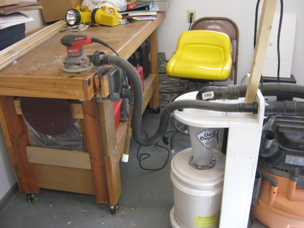

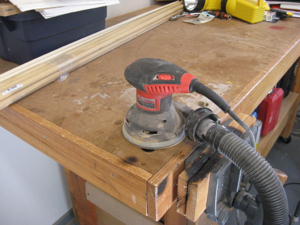

A bearing finally went out a couple of years ago.... Bought this one for $69.00 at HD.
velcro paper works slick.... Rigged up an old vac hose for dust collection..
dust collection works really good with this. it comes with a little bag for dust but, that is so,so.........it is also variable speed...........
when it is done buy another one for that low a price............[ATTACH]18116[/ATTACH]
[ATTACH]18117[/ATTACH]
