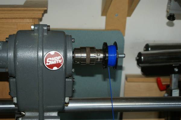

Ed;
The speed reducer and the Power Pro yields about 35 RPM. Good for this type of job.
[ATTACH]18118[/ATTACH]:D

fixit
Posts: 439
Joined: Fri Jul 21, 2006 8:44 pm
Location: La Vernia, TX
Post by fixit »
Great thinking Bill!
Thanks for the idea. I'll use it the next time I have to reload my trimmer - which will probably be this afternoon.
