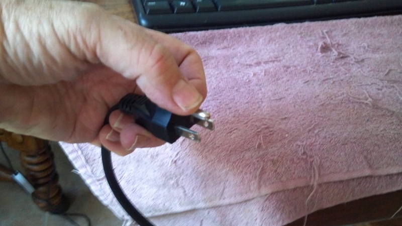

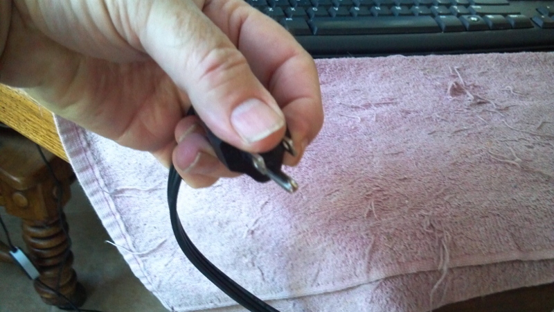

Well here is my take on this subject. Most people grasp the plug with their thumb on top to insert or remove it from the wall plate. As you can see in the photos, with the ground on the bottom you stand a good chance of touching the business ends of the plug. If the ground is on top, you are blocked from the business ends by the ground prong.
[ATTACH]18159[/ATTACH]
Zappp!!:eek:
[ATTACH]18160[/ATTACH]
