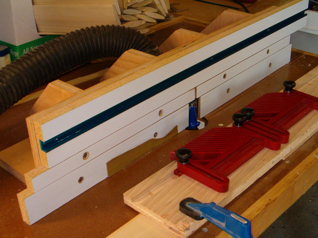

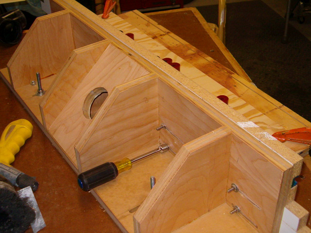

Been wathcing this thread with wonder. I am confused! You are routing from above, right? Would make a big difference if routing from below.
When routing or shaping from above, I have been very pleased with Shopsmith fence shown in Post #2 from SDSSmith. You can also use a wood table and fences as shown for use in the Sawdust session on OPR use.
If routing from below there are a huge number of designs. Here's mine.
[ATTACH]18171[/ATTACH]
[ATTACH]18172[/ATTACH]
New Router Fence.jpg (138.47 KiB) Viewed 2487 times
Rear of fence.jpg (134.23 KiB) Viewed 2400 times
