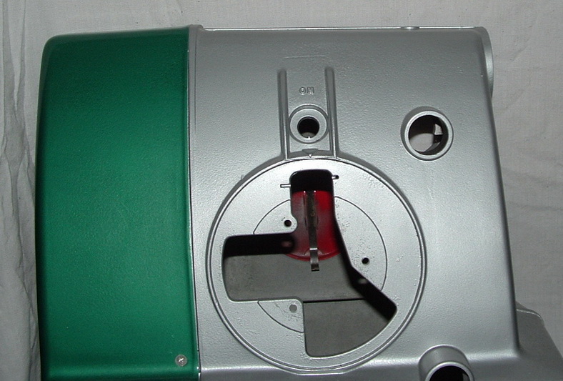

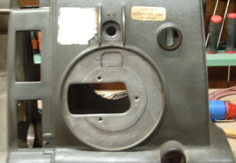

This is a picture ofa headstock casting of my most recent acquisition. It is a B casting , but check the cut-out behind the speedcontrol. SER # 186343, late Sept 84 build date.
My other gray unit is from summer 83, ser # 157707 and it has the same "Texas" shaped cut out as my 56 Greenie case that is pictured.
So does that mean that we really have A B C and D cases?
- SS ODD B CASTING.JPG (135.47 KiB) Viewed 2284 times
- SS B CASTING 56 GRNIE.JPG (153.08 KiB) Viewed 2276 times

I'm guessing somebody left out a core piece when it was cast.wiredone wrote:This is a picture ofa headstock casting of my most recent acquisition. It is a B casting , but check the cut-out behind the speedcontrol. SER # 186343, late Sept 84 build date.
Hang onto that un. It may be the only wun of its kind!:Dwiredone wrote:Any one else seen this?
I did see this small rectangular opening on an 80s unit that I repaired and sold once. It caused an alteration on how to put together Bill Mayo's fix on the speed-control (bolt and nut had to be installed after mounting the speed control in the headstock).wiredone wrote:Any one else seen this?
Chris
Yeah, I can see where that would be an interference situation.
Love to know what the real story is though. Maybe a batch of castings that as RED suggested, didn't get the proper blanks installed during the process?

I have seen many later model (80s) headstocks like your odd one. It is still a "B" headstock with a little more strength in the speed control assembly area. Shopsmith made many upgrades like this over the years with the same part number.wiredone wrote:This is a picture ofa headstock casting of my most recent acquisition. It is a B casting , but check the cut-out behind the speedcontrol. SER # 186343, late Sept 84 build date.
In fact, in my instructions for the quadrant bolt kit, there is a picture of this headstock casing and where you have to file the casing to get the speed control assembly installed that has the bolt vs the roll pin. All I need is your home address to send anyone the quadrant bolt kit, no charge.
interestingly Red, that one on Ebay is even a little more different! It is cut out behind the tension spring, mine is not.
I knew there would be answers!!
