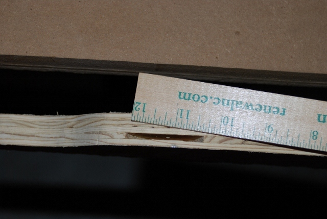

Gents,
I screened the searches for my problem but to no avail. Youtube was no help, either. Here's my problem:
I'm making a set of bookshelves for the playroom and I've cut everything from 3/4" oak plywood. Everything was going great until I looked at the fourth end piece (making 2 sets of shelves) and noticed that the 2nd layer of plywood is absent from an edge I planned on routing. The missing plywood forms a pie shape that has a cord of about 2 inches, with the pie cutout pointing towards the center of the board. I was planning on staining these an ebony color, so whatever fix I do needs to be able to accept stain.
I don't know how well I could bust another piece up and try to wedge a fit (I would appreciate tips on that, too). Of course, I could fill it in with sawdust and glue or some filler, but then I'd have to paint. I don't want to buy another sheet of plywood just to have a bookshelf.

Lowes sells wood putty filler that is sandable and stainable. Minwax is one brand. I don't know how it would handle the router. If it chips or something then you can repair the repair after routing and sand it to match the contour.
If you can change your plan and not rout it, then you can buy iron on oak veneer tape to cover the plywood edges. I have used it on 3/4" oak plywood with great results. I know Woodcraft sells it and I have been told that Lowes does too.

I'd glue in a patch sawn from a scrap piece of plywood or solid wood. Using the bandsaw and a fence you'll make plenty of filler samples in short order. Set the fence to the thickness required and then cut the arc to match the void. If you need a perfect fit because of the profile you're planning, you could make a pattern of the void out of paper and then cut the patch to match. Let the patch stand a little proud of the void and trim the excess after the glue dries.
I wouldn't use glue and sawdust as the stain won't be absorbed by the glue and the patch would be visible after staining.

The idea to resaw using the bandsaw came to me after I went back to the garage and stared at it a little while longer. I actually think it looks pretty good. I may have to do a little fill in with the products mentioned above after routing. Thanks for the help, fellas.

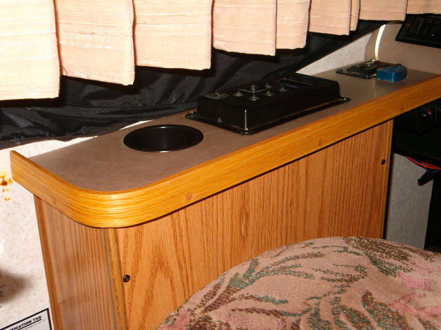

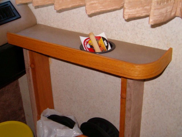

Maybe I'm a little late with this solution, but here it is anyway. Maybe it will help for other plywood edged projects. Solid Oak strips are the clear solution. Ripping solid oak strips - about 1/8" thick - are good solutions for many curved plywood edges. For straight edges, the ripped strips can be thicker.
For curved edges, you may need a clamping jig the same shape as the project in order to get a tight joint.
Here's a project made from glued 1/16" strips in order to go around the tight corners of a plywood base. In this case the strips were built up to about 3/36" thick
[ATTACH]18221[/ATTACH]
[ATTACH]18222[/ATTACH]

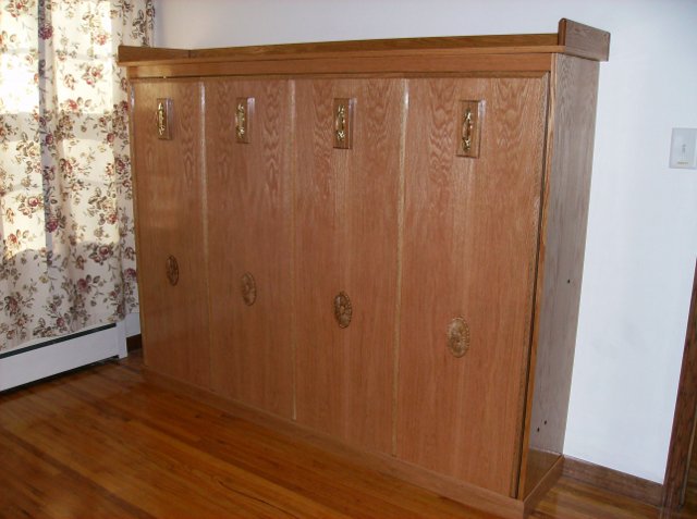

A plywood edge will never look good stained or painted, so if the edge will be seen, either add hardwood strips to the edges to hide them, or get some of the iron-on veneer to hide it. If you use the veneer, you can't router the edge. To get a fancy routered edge, you want hardwood strips wider than the router cut.
This is a Murphy bed I made last winter. All the large pieces are plywood. You can see the iron-on veneer hiding the plywood edges.
- murphy.jpg (81.65 KiB) Viewed 3693 times
