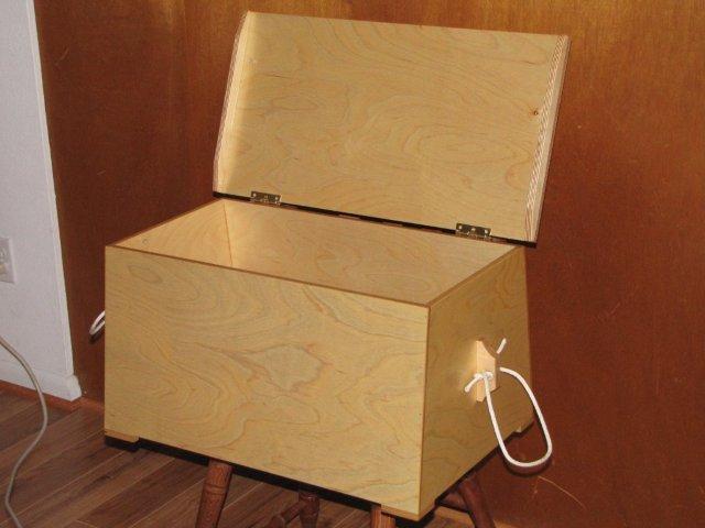

Yep, ditto things said above. I've built a couple of drawer units out of baltic birch, both the outer cabinet and drawers using half-blind dovetails for the drawers and butt joints for the outer shell. Used daily for several years and holding up well. You will need to use backers on both sides of the ply to minimize tear-out. I used TiteBond II for both projects.
I also built a smallish sea chest for my first grandson using BB with the ends set in rabbets (added support and to mostly hide the ply edges on the outside of the box). It has survived the family pirate hauling/dragging it around for the last 3 years quite well.
