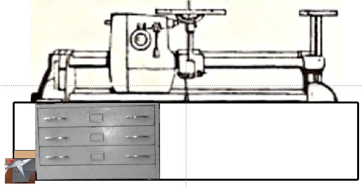

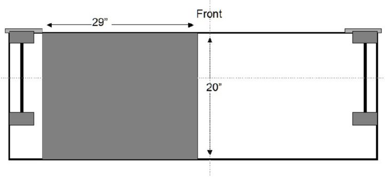

Here’s my winter project:
I have a 510 that I am going to build a cabinet underneath to house miscellaneous small to mid-size tools. I plan to expand this so that it is wider (not longer) than the current base. The width is determined by a metal cabinet I want to incorporate. I plan on using salvaged parts from a VII I parted out so that I can have castors that can be lowered and elevated. I want to do this without replacing the rods that run through them with longer ones but adding a few inches at the back will provide a lot more storage space.
I can abandon incorporating the metal cabinet so that is not a requirement if just building a new cabinet will work better.
Currently the metal cabinet houses many small tools and parts. I want all of this to go in the cabinet along with saw blades with arbors, saw blade guards, miter gauge, etc. If I use this cabinet this will need to go on the left below the headstock because of clearance for the table, otherwise I lose about an inch for lowering the table. The fence could go in a slot above the left castor since that might be wasted space.
The attached photos are concepts. The length of the cabinet will probably be 70-72 inches. The gray metal cabinet pictured is 29Lx20Wx18H. So that leaves about 35 inches on the right for additional drawers. I plan on putting these on suspension rollers like what are available on file cabinets. Picked up a few over the years for mice nuts (smaller than peanuts) at garage sales.
The footprint between the castors on the Mark VII parts is 15 inches so this increases it to about 19.
So what would you do? How would you design this? Will there be a problem if the castors are unbalanced beneath the SS as shown in the second photo? Do I need to shorten or lengthen the base so that when it is upright it is still balanced?
I spent my career as a corporate psychologist, not an engineer. I understand why people do things (brilliant and stupid) but that doesn’t mean I know how to do brilliant things. I do know that it is best to ask first (measure twice), evaluate and then proceed – with caution and the ability to ask again, and again if necessary.
All suggestions (drawings, pictures, internet links, etc.) will be reviewed and appreciated.
Note: Drawings are not to scale. Hey, I’m not an engineer.

I would make the added depth protrude from the rear, not the front. Allow for toe room as well(keep it off the floor). Other than that, any thing goes.

Do I have this backward? I thought the added depth was at the back. How much Toe Room? I thought I would use the brackets I cut off from the Mark VII as a gauge. Do in need more? Thanks for the reply.JPG40504 wrote:I would make the added depth protrude from the rear, not the front. Allow for toe room as well(keep it off the floor). Other than that, any thing goes.
db5 wrote:Do I have this backward? I thought the added depth was at the back. How much Toe Room? I thought I would use the brackets I cut off from the Mark VII as a gauge. Do in need more? Thanks for the reply.
Backward? Maybe. The two pix are ambiguous.
The first shows the steel cabinet on the left.
The second makes sense only if a 'bottom view' looking up.
Both show the cabinet on the left in the 'pix'. Adding the word 'front' implies the top of the pix is the front, but is easily overlooked.
Drawings are usually as viewed from front, sides, top, bottom or a projected angle view. The words top, front, bottom, back, left, right usually refer to the view of the drawing, not an edge and may include the word 'view'.
Toe room depends upon yer foot/shoe dimensions, but three inches(depth and height) will usually suffice. Look at yer kitchen counters.
P.S. The caster footpedal needs 'toe' room also.
Toe room.. Maybe try your rig in all configurations stand there as you would to do work,
then look down maybe chalk the floor by your toes then look at all your chalk marks and then decide the dimensions.

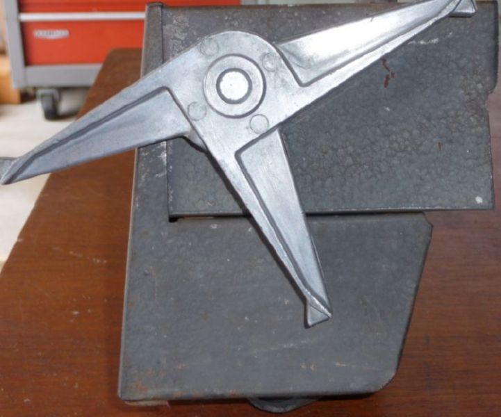

I'm using the castors salvaged from the Mark VII (attached picture). I hadn't thought about the lift assist but went online and it looks really great but I don't think I can justify spending $400+ to get one. I would be willing to give up the storage, however.lightnin wrote:Are you using the Shopsmith legs and castors?

- Castors.JPG (63.94 KiB) Viewed 1396 times

BUT I wouldn't build anything that does not fit between the casters. I would not go wider at all, I don't like the idea of weight being put outside the casters. To me that seems like it would make it easier to tip or FEEL like it's going to tip. The rest of the lay out to me seems to depend on what you feel best with
