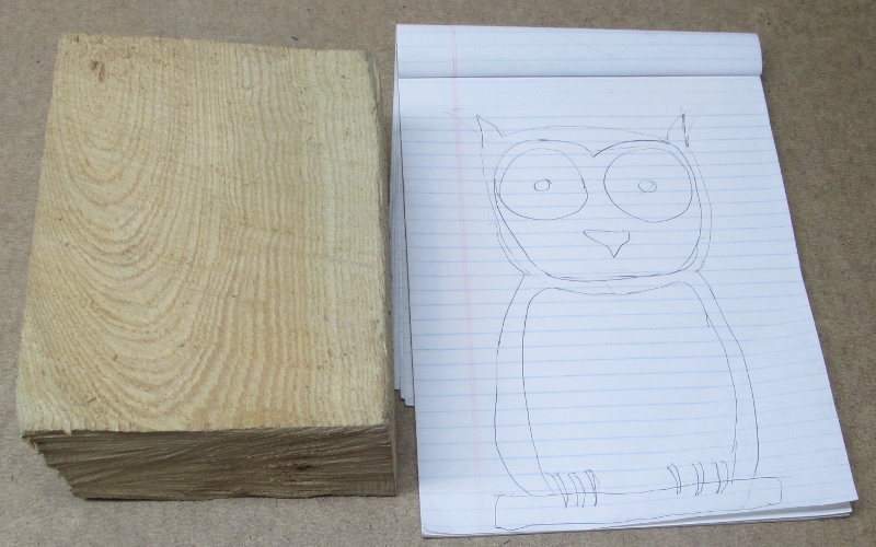

I am making an owl band saw box for my wife. We have an anniversary the second week of September and I want to give it to her then.
As starting point a block of Hackberry (the oither side of the block is more interesting) and a drawing

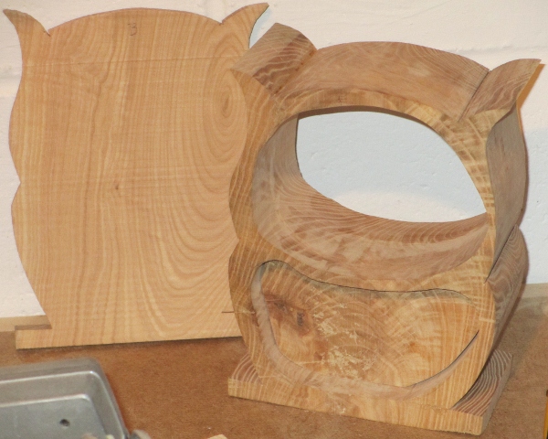

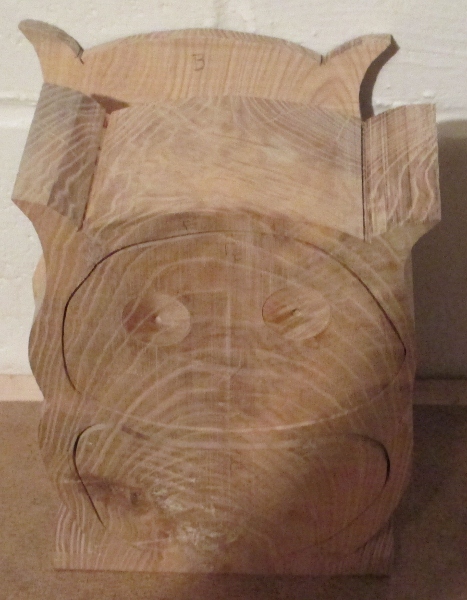

To here so far (next 2 pics)
[ATTACH]18332[/ATTACH][ATTACH]18330[/ATTACH]

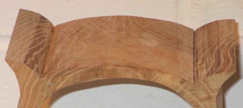

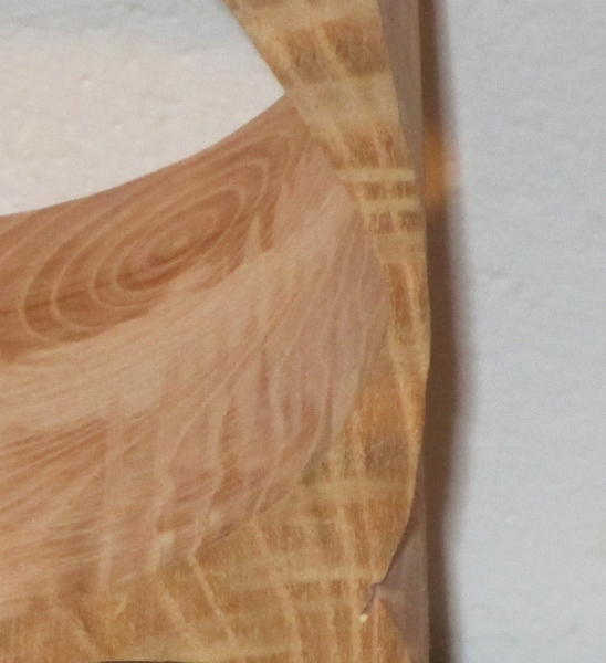

A couple of issues
[ATTACH]18329[/ATTACH][ATTACH]18331[/ATTACH]
The first issue is that a lot of my cuts went too far leaving saw marks too deep to sand out. Any ideas to minimize their impact would be helpful.
An other issue is that the table insert or the hole for it caught my work piece while I was cutting out the upper drawer and I, unwisely 8-(, kept trying to feed the work around the curve. I should have stopped sooner and looked for the problem. So, not a very smooth ark on the right side of the box.
A couple of issues
A couple of issues
A couple of issues

Don't let the "mistakes" bother you. Remember, this is a hand made piece of art, not a production piece. What you consider flaws are unique marks of character. The best advice I can give you is don't stress about it.
I don't think the spots where your saw went a little too deep are a big deal. Make them the same on both sides and use them to show definition between the owl's body parts.
I wouldn't sand any more than is necessary on the outside of the drawers and inside of the drawer cavity. Don't try to "correct" a shape by sanding away wood there. You'll end up with a big gap and ill fitting drawer. The shape is what it is and what it is is just fine.
If you want the drawers to sit a little proud, you can glue a shim to the back (inside the cavity) to stop the drawer at the depth you want. Might be easier than sanding down the frame that much.
