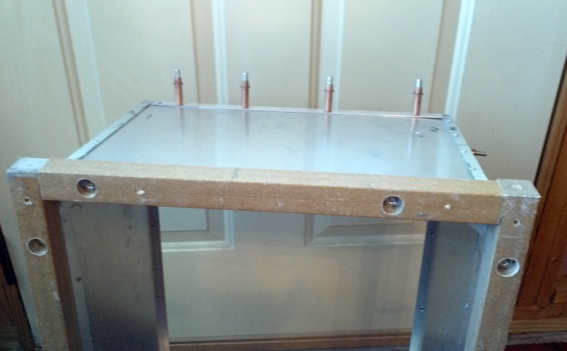

Current project with composite... Air conditioner cover.
The composite will end up attached to exterior of pouch it's attached to
the cover at this point for alignment.
[ATTACH]18394[/ATTACH]
