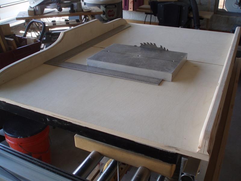

What you have done is not stupid, Morgan! Whenever an operation does not feel right, STOP. Re-evaluate or ask questions.
The ultimate solution for your problem would be a cross-cut sled. Using a sled provides for control of the work piece. It is when you lose control of the work that you are most likely to get hurt.
Please ignore the framing square and block of aluminum. These are not applicable to this discussion. I use those items as a "quick check" for sled positioning.
[ATTACH]18415[/ATTACH]

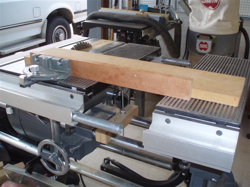

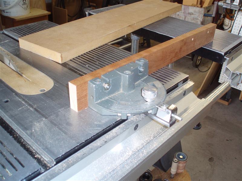

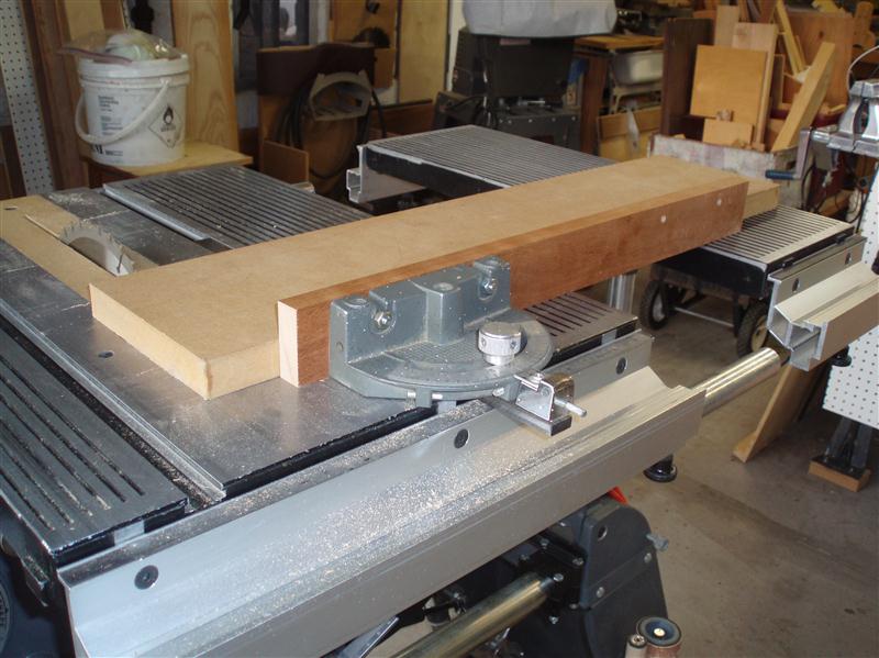

An immediate solution could be an extension to your miter gauge fence. The miter gauge fence is just too short for the size of the work pieces involved. Even this extension is likely too short; a simple matter of using a longer piece to fabricate the extension.
[ATTACH]18412[/ATTACH]
[ATTACH]18413[/ATTACH]
[ATTACH]18414[/ATTACH]
Extending the miter gauge fence to about 36" long (or longer) might be necessary to give you the additional work piece support that you need.
Study the information contained in the link that reible provided. I believe they provide information there on miter gauge extensions.
