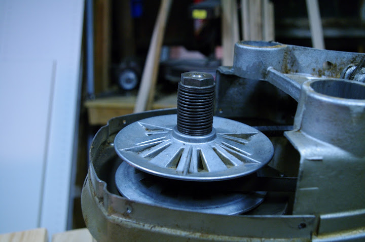

But...and here is why I'm starting a new thread, my headstock has been seriously messed with. Here is where it sits right now (if I use the wrong terminology I appologize...I'm still a newbie):
You can see that the control sheave has been removed and replaced with a standard pulley.
Another shot of the pulley in the control sheave's place.
The idler sheave still seems to be intact
And this is where I stopped the tear down. Everything I've read and looked at today hasn't shown the metal retaining pieces around the bearing in between the bolt.

This is something else I haven't found information on. All the instructions I can find state that this spring is held down with a snap ring. On this one it's a nut. I'm not sure if it's just because of the vintage, or if I'm missing something.

The speed adjustment dial was also in the box. Turning it didn't seem to move the worm gear at first. I got it to move, but it's very stiff. The teeth are looking pretty worn also. FIXABLE _ REPLACE PIN WITH SCREW?NUT, STRAIGHTEN "LEGS"(CAREFULLY) _ FILE TEETH IF NEEDED
This is obviously not the correct belt. There's a lot of slop and it's quite worn.
This is something else I haven't found information on. All the instructions I can find state that this spring is held down with a snap ring. On this one it's a nut. I'm not sure if it's just because of the vintage, or if I'm missing something. NORMAL FOR AN EARLY GREENIE - BE AWARE - LEFT HAND THREAD
So here is my first question]http://www.ebay.com/itm/320629142415?ss ... 1438.l2649[/URL] MIGHT WORK

Last thing is that retainer at the idler. Maybe it's just inexperience, but I'm really hoping that hasn't been monkeyed with. A NORMAL EARLY GREENIE

See embeded comments in RED
It is late so I will leave finding relevant posts/thread for another day. Bill Mayo(and I) have posts/thread relating to speed control fix and the idler shaft retaining clips.
You have an early sand cast greenie. The headstock casting is heavier and rougher(IMHO better):)
