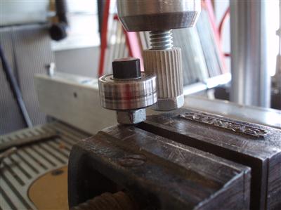

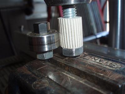

Trying to Sort Out Noisy Bearings
I thought, while I was routing through all these old bearings, that I'd test to see which ones might be good.
[ATTACH]18508[/ATTACH] [ATTACH]18509[/ATTACH]
For some reason this does not work. I have bearings that squeal when installed in the bandsaw but sound fine when spun like this.
I'm stumped.
I'm stumped.
- 002 (Custom).JPG (25.96 KiB) Viewed 2516 times
- 003 (Custom).JPG (24.08 KiB) Viewed 2512 times
