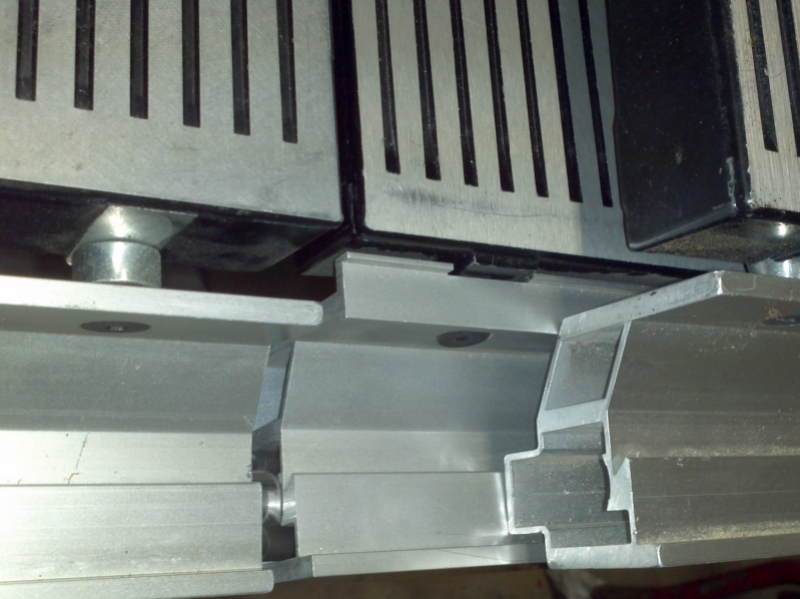

Methinks I found part of the problem.
The rail on one of the tables is different from the others It looks like it's for the Pro version it don't have the magnetic strip though.
[ATTACH]18558[/ATTACH]
That was the one I started with and could not adjust it's as if the holes in the table were in the wrong spot.
The rail could not snug up to the gauge there was a small gap.

You are right. You have a mixture of rails. Which version do you have the most of (with the magnetic strip or without). I have not tried to co-mingle them but I don't believe you can.lightnin wrote:Methinks I found part of the problem.
If you have a PRO version that you would like to trade, we might be able to cook up a deal.

My comments are below in RED
lightnin wrote:
That was the one I started with and could not adjust it's as if the holes in the table were in the wrong spot. Hmmm, this could mean that one of these table started life as a the first generation of the 510]
The rail could not snug up to the gauge there was a small gap.The gauge will still work; but you've got to use the gauge on the very thin lip that is the highest point on the rail. If you put the gauge at the corners, that black "boss" or pad that the rail is cut out to fit around gets in the way of the gauge sitting back far enough to so that it can engage the lip of the rail. You either have to angle the gauges at the corners back at a 45 degree angle or just use the gauge in the middle.
