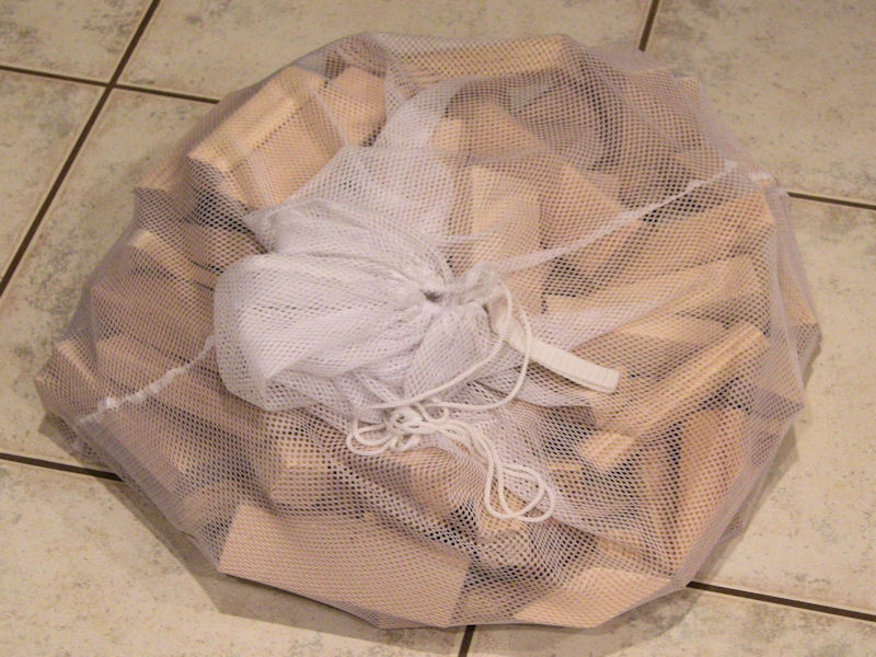

The lighter the wood the better as they often become projectiles. As few sharp ends as possible. Round all edges and sand well to knock down chances of splinters. Finish, either salad bowl or none would be my suggestions. I made a large amount and the kids, no matter what their ages still like to play with them. I keep them in a nylon knit dirty clothes bag with a draw string. Make at least two of every shape.

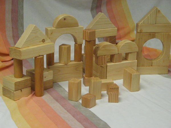

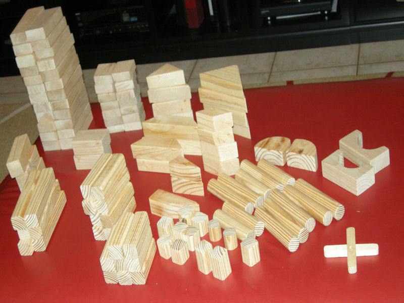

Blocks
I made 2 sets of these a couple of years ago. Scrap 2 x 4 stock (fir and yellow pine). The rounds were from dowel stock from a closet hanger rod. For the finish I used Emmet's Good Stuff from Bally Block Co. I found this when I installed a butcher block counter from Bally. It's a food safe product. For a 'bag' I got sweatshirts with the kids names on them. The wife cut off the sleeves sewed up the sleeve and neck openings, turned the waist up and sewed a opening for a cord which when pulled closes the shirt into a bag. Sorry, no pics of the bag.
Good luck and be sure to post a pic when complete.
[ATTACH]18562[/ATTACH]
- IMG_1461.jpg (42.06 KiB) Viewed 3097 times
