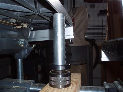

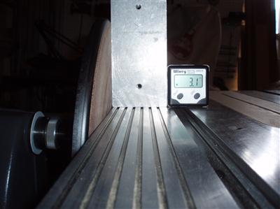

Another way would be to use the Wixey as suggested and tweak using the adjustable stop collar to vary the tilt angle. This is what I have been doing on recent projects.
[ATTACH]18603[/ATTACH] [ATTACH]18604[/ATTACH]
I use the aluminum block as a square. It is as accurate as my engineer's square.
The left side of the block is pressed up against the conical disk.
In reality, I would not normally use the Wixey for this setup unless I wanted something other than a 90° edge.
Note the relative angle of the conical disk is not 4°s.

- Measuring Table Tilt 006 (Custom).JPG (22.4 KiB) Viewed 2534 times
- Measuring Table Tilt 008 (Custom).JPG (26.14 KiB) Viewed 2532 times
