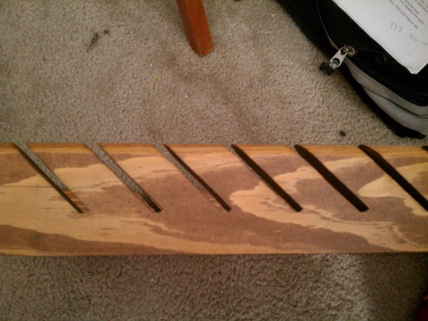

I'm trying to replicate this cut and am hoping for some help.
The cuts are approximately 3/8 inch wide, 2 1/4 inch deep, and set at a 50-degree angle. They are also 7/8 inch apart.
The wood is 1 x 3.
I tried using my dado on its narrowest setting (inside & outside blades only) but can't seem to get the angle/depth right.
Any helpful suggestions?
Thanks!
Morgan
The wood is 1 x 3.
Thanks!
Morgan

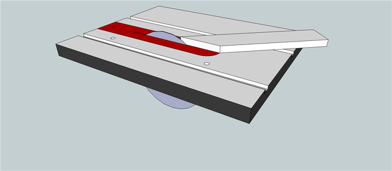

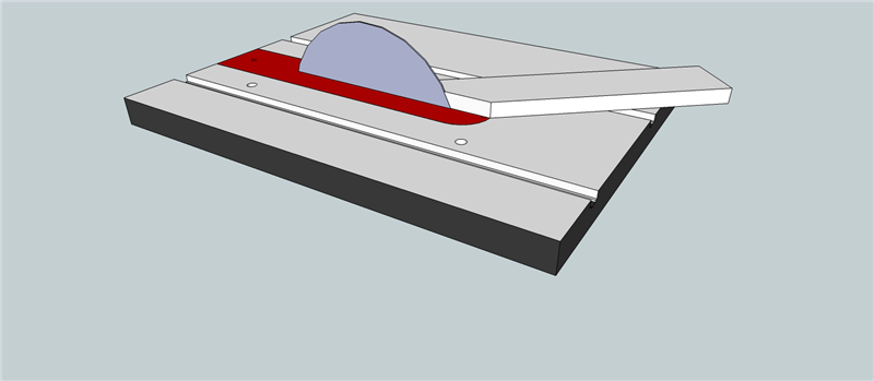

No, you are right on. This will work BUT doing it this way introduces some hazard that must be considered. To minimize the amount of chisel work (to square the slot), the table will need to be lowered. This makes the slot more vertical but at the same time exposes a lot of the blade.a1gutterman wrote:Am I missing something? Why can't you lay the board flat, like your picture shows, on the saw table that is also in the normal position (perpendicular to the blade), raise the dado blade as high as it will go (to create as flat a bottom as possible) and use your miter guage (which CAN be set to 50 degrees) or a sliding table. You can then clean up the bottom of the cut with a chisel. Or am I missing something?
It will also be necessary to utilize an extension on the miter gauge. It was not stated how long these pieces are but the longer they are the longer the fence should be to maintain stability.
Note the angle of the blade as it passes through the 3/4" stock. Raising the table reduces blade exposure but also increases the angle of the blade.
[ATTACH]18692[/ATTACH]
Lower Table, Deeper Cut, Less Angle
[ATTACH]18693[/ATTACH]
Higher Table, Shallower Cut, More Angle
[ATTACH]18690[/ATTACH]
