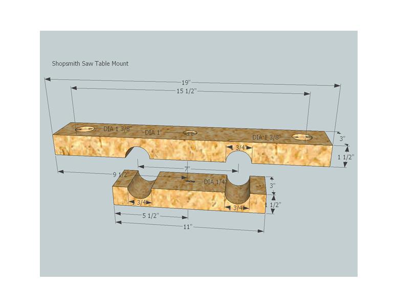

I wanted something on the SS where I could mount the main saw table when it was not in use and I wasn't using one side of the SS so I built this mount. Now, I don't have to go far to find a safe place for my saw table. I know the table support tubes are 1 1/4" but the 1 3/8" holes make it easier to lift the table out of the mount. You could also make one hole 1 1/4" and the other 1 3/8". When drilling the holes that accept the table tubes, offset them at least 1/4" off center so more of the table top is supported on the 3" wood top of mount. I used a 3 1/2" long 1/4-20 bolt with a t-nut and hand knob (on the bottom)to tighten the two pieces together around the SS tubes.
- SS Saw Table Mount_1.jpg (32.09 KiB) Viewed 805 times
Not a bad idea at all! Knowing that the table is stored properly, when not in use, saves a lot of concern. I have always just leaned mine against a near by work bench but it has been knocked down several times.wasatch wrote:I wanted something on the SS where I could mount the main saw table when it was not in use and I wasn't using one side of the SS so I built this mount. Now, I don't have to go far to find a safe place for my saw table. I know the table support tubes are 1 1/4" but the 1 3/8" holes make it easier to lift the table out of the mount. You could also make one hole 1 1/4" and the other 1 3/8". You may make it as fancy as you'd like. I used a 3 1/3" long 1/4-20 bolt with a t-nut and hand knob to tighten the two pieces together around the SS tubes.

In the Winter 56-57 ShopMag issue, there was an open box-shelf. It is 4" wide, 19" long and 6" high. Mark the 1 1/2"holes for the table-riser tubes by laying the table flat on the bench and lining up the shelf piece wit the table. A mounting block is centered between the two twin shelves and nailed in place.
Tilt the saw table to the drill-press position. Then, simply slide it along the wall, line up th edge with the shelf, and tubes will slip into holes without fumbling.
