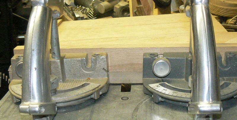

jig (sled) for conical disk thickness sanding
Pretty crude, but easy to make.
The bed taper matches the conical disk so the main table remains at '0'.
From the disk side.
[ATTACH]18732[/ATTACH]

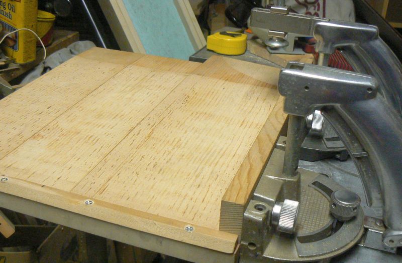

From the front.
[ATTACH]18733[/ATTACH]

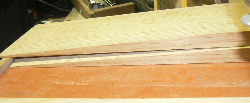

The bed is in three pieces.
[ATTACH]18734[/ATTACH]

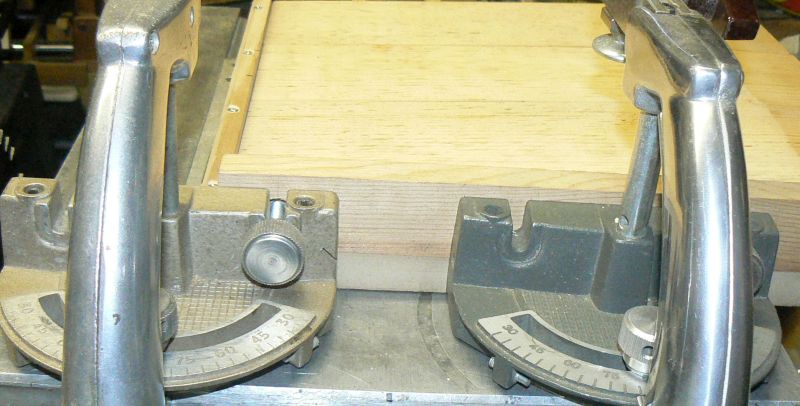

The sled can be attached to the two miter gauges two ways(left/right).
[ATTACH]18735[/ATTACH]
If I were to make it over, I would move the miter gauges to the right or use miter bars only and lower the front lip to allow the disk to pass off the end of the work piece.
Also DC needs to be added!!!!
