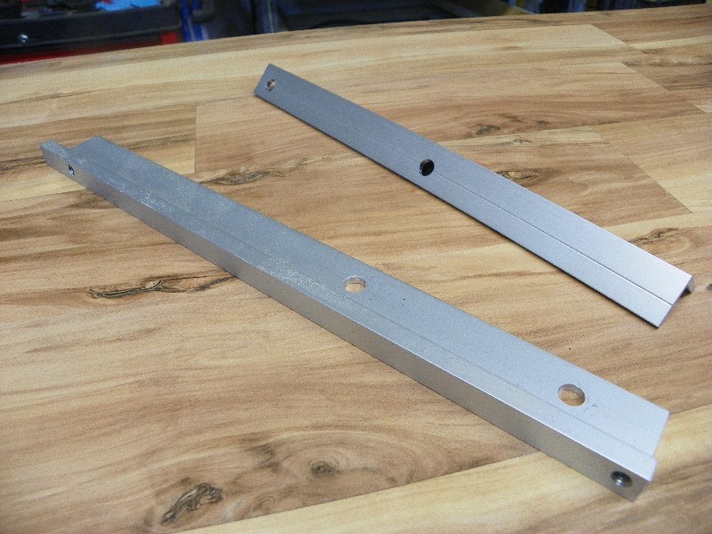

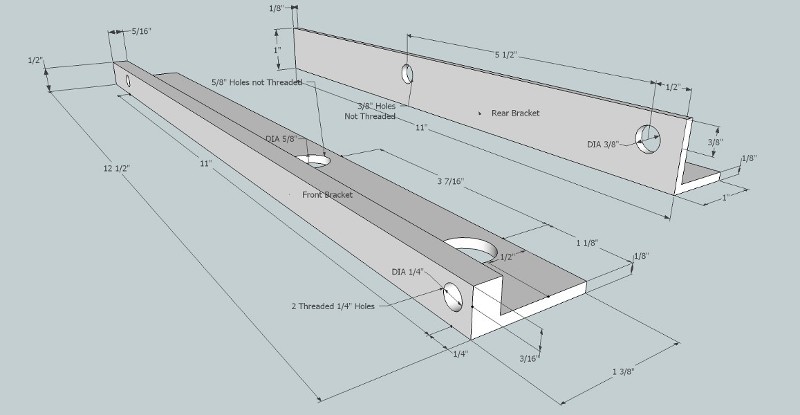

Hank, I hope this is what you are looking for:
The front and rear piece reference photo
[ATTACH]18751[/ATTACH]
Here is the Sketchup version with measurements. Hope I didn't miss anything.
[ATTACH]18752[/ATTACH]
Kreg Band Saw Fence Brackets.jpg (45.26 KiB) Viewed 3466 times
George

George, many thanks. That is just what I need. I will go to work on this task to see if I can make the non-SS fence work for me. I really appreciate the time and effort you invested in providing the information. Hank

George, I am curious (sorry, but I couldn't resist that, given your forum name!) about the SS rear rail that attaches to the rear of the SS bandsaw table. Does your Premium SS/Kreg fence in any way attach to, contact, or ride on the rear rail? The non-SS fence that I have doesn't have a rear rail assembly as I recall (I am on the road, so I am not able to say for sure).
Your dimensions were dead on in terms of how the front and rear SS fence rails would match up with my table and the pre-drilled holes on my non-SS fence system.

The rear rail supports the fence when you move it to the left of the table. The instructions tell you to shim the rear rail such that the top of the rail is even or slightly below the bandsaw table surface.
