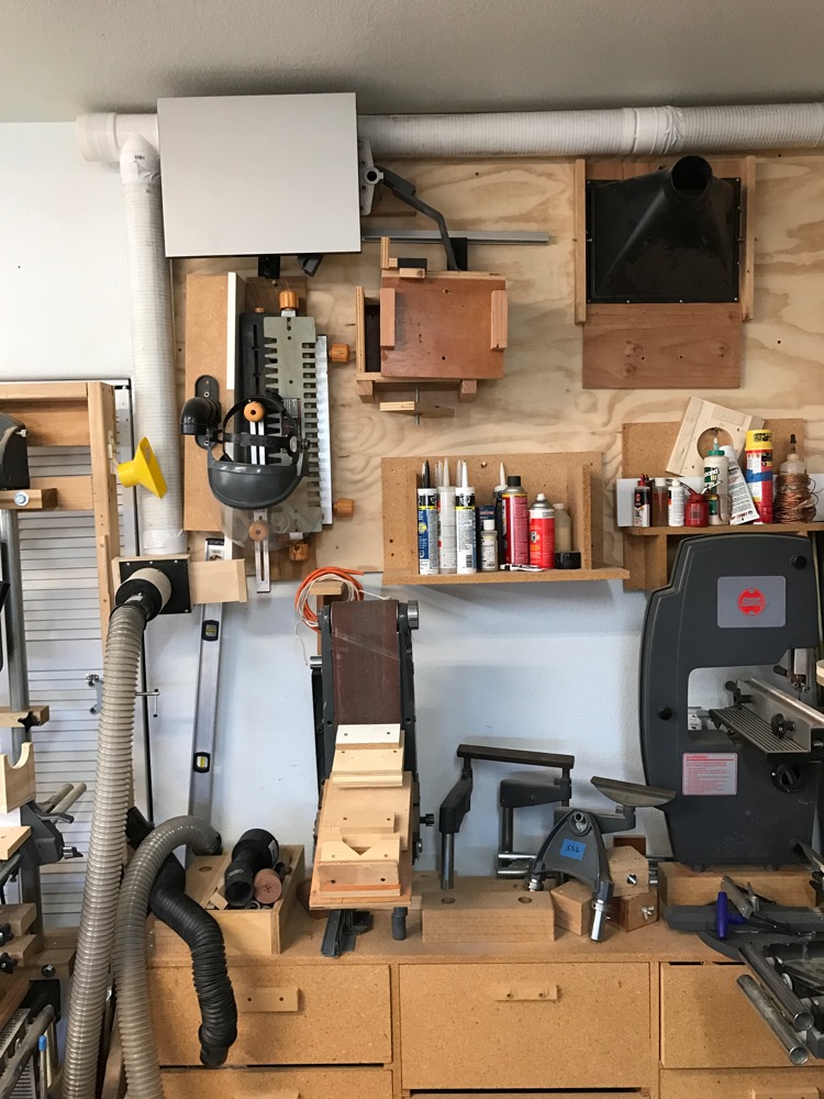

The duplicator is a pain to store. You can see all but the cutter/follower parts are in this picture. The cutter/follower are stored in a cabinet.

SDSSmith wrote:The duplicator is a pain to store. You can see all but the cutter/follower parts are in this picture. The cutter/follower are stored in a cabinet.
I like the setup you have for storage. I use to have something like that but then it became a full blown shopsmith again. Hadn't thought about storing the table like that... wonder if I have enough room to do that....

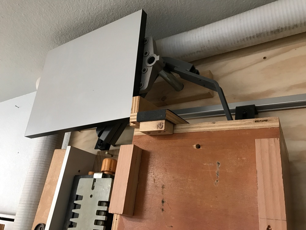

I mounted mine high up on the wall using a 2X4 drilled out to accept the table legs. I don't use it often so it's up out of the way. The work really well when you need them. I use carbide bits I bought at Woodcraft that they sell for the Sorby lathe chisel that has the replaceable carbide blades. The screw that holds them on is very similar. On a trip to the fastener store I found a replacement screw that had the same threads as the duplicator but a slightly larger flat head to match the Sorby blades. They make a huge difference.
Paul
