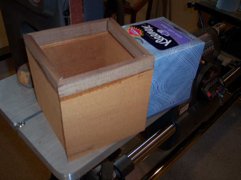

Four years ago I had made a tissue-box after seeing one in the Toledo Woodcraft store:
[ATTACH]18872[/ATTACH]
Someone seeing that box requested one of their own lately. So I finally got around to that.

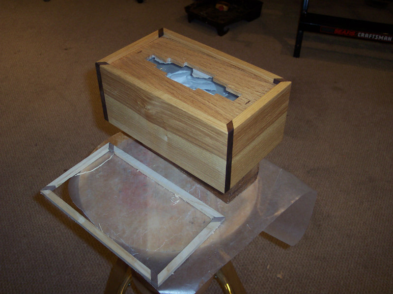

Here's how all my preaching backfired on me:
- Had ordered some nice dimensioned wood from an in-state eBay guy (<100 miles away, perfect eBay rating). After 2 weeks of no UPS visits, I contacted the seller who dug and dug and concluded UPS had lost the wood. So much for salvaging that! I had to work with some other wood I dug up.
- Got real proud of my corner-miter cuts on some Ash planks, until I realized all 4 pieces were too short laterally to fit around a tissue-box!
- Panicked, decided to add in some gap-filling walnut pieces. Decided to use 15-min-cure Epoxy to make sure the joints were strong and all gaps were filled. Come trim-up time, epoxy is tough! No plane-shavings for that stuff, I had to grind down the squeeze-out dried glue with a long session at the Disc Sander.
- Top piece wasn't planned to have the two tiny "keys" holding the bookmatched Oak halves together. I had to put those keys in following a mistake on the bandsaw -- to fill up unintentional kerfs!
- Next: I decided the box was too tall in appearance. Then I found I couldn't get it fit in the bandsaw to trim off a bit from the bottom edges. Back to my recently-restored Rip handsaw. It actually works very well, especially, given its traditional teeth, if I lift it slightly during the backstrokes. You can also see traces of some long shavings left as the sharp teeth 'chisel' through a rip-cut.
So here is the short project made long... now finally ready for some finishing.
[ATTACH]18873[/ATTACH]

Hey Chris, nice job and thanks for pointing out realities of woodworking. Every project I make has varying errors that force changes which for some reason seem to enhance the outcome. I recently made a pair of saw handle style canes. Having already made a few I was moving right along when I became a bit to aggressive with the band-saw. I realized I had totally changes the handle shape on one of them. The friend that I made one for preferred the handle on the one I over shaped over the original style. One just has to adjust and continue. Jim

That turned out good. No one would know that you did not plan it that way. Isn't that part of being a good woodworker, you are able to cover your mistakes?

There are no mistakes.
Just opportunities to improve your skills or adapt a skill to a new method.
Chris,
Nice Job and good save!

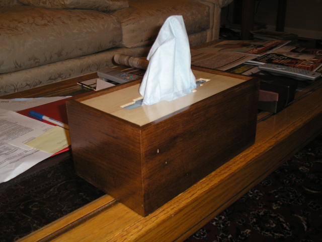

Started Another Box
The title is still appropriate -- now with allergy and/or sinus virus, I just don't feel like finishing the job any time soon! I guess that's what browsing the forum is for.
I started another tissue-box. Bevels were done with the bandsaw, and I'll be trying a new technique for precision trimming of these parts... when I get to it! Also will probably trim the top-walnut and add a similar bit of decorative bottom-walnut. The main part is mahogany.
